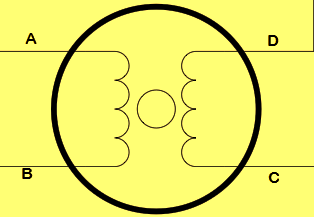

Unipolar Stepper Motor Windings
Stepper Motor can be easily interfaced with PIC Microcontroller by using readymade ICs such as L293D or ULN2003. As I said in the article Stepper Motor or Step Motor, we have three different types of stepping modes for unipolar stepper motor.

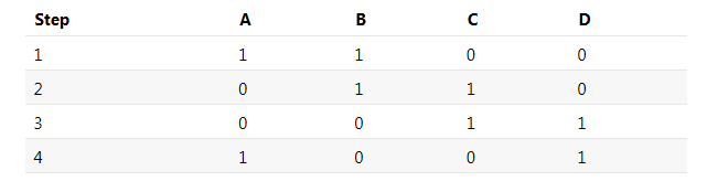

Full Drive
In this mode two stator electromagnets are energized at a time. It is the usual method used for driving and the motor will run at its full torque in this mode of driving.

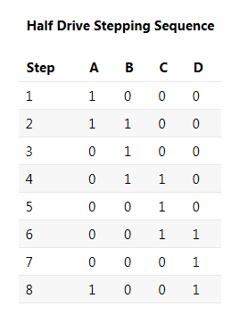

Half Drive
In this stepping mode, alternatively one and two phases are energized. This mode is commonly used to increase the angular resolution of the motor but the torque is less approximately 70% at its half step position (when only a single phase is on). We can see that the angular resolution doubles in Half Drive Mode.

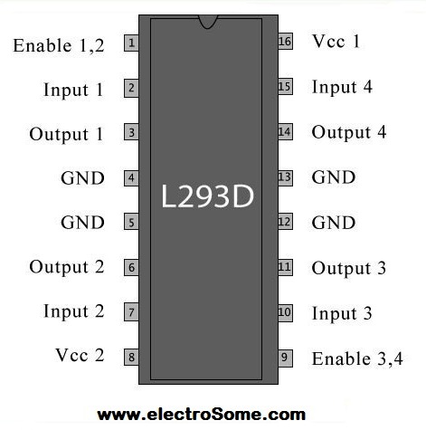

L293D and L293 are dual H-bridge motor drivers. The L293D can provide bidirectional drive currents of up to 600-mA at voltages from 4.5 V to 36 V while L293 can provide up to 1A at same voltages. Both ICs are designed to drive inductive loads such as dc motors, bipolar stepping motors, relays and solenoids as well as other high-current or high-voltage loads in positive-supply applications. All inputs of these ICs are TTL compatible and output clamp diodes for inductive transient suppression are also provided internally. These diodes protect our circuit from the Back EMF of DC Motor. In both ICs drivers are enabled in pairs, with drivers 1 and 2 are enabled by a high input to 1,2EN and drivers 3 and 4 are enabled by a high input to 3,4EN. When drivers are enabled, their outputs will be active and in phase with their inputs. When drivers are disabled, their outputs will be off and will be in the high-impedance state.
PIN Diagram of L293D

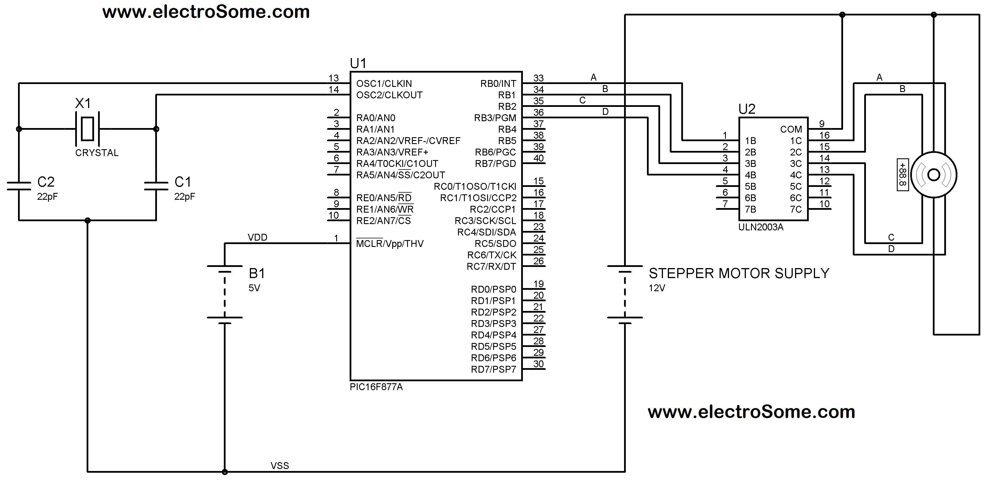

ULN2003 is a monolithic high current and high voltage Darlington transistor arrays. ULN2003 consists of seven NPN Darlington Transistor pairs that have high-voltage outputs with common-cathode clamp diode for switching inductive loads. The collector-current rating of a single darlington pair can be up to 500mA. We can connect Darlington Transistor pairs in parallel if higher current capability is needed..

Interfacing using ULN2003
Interfacing Unipolar Stepper Motor with PIC Microcontroller using ULN2003

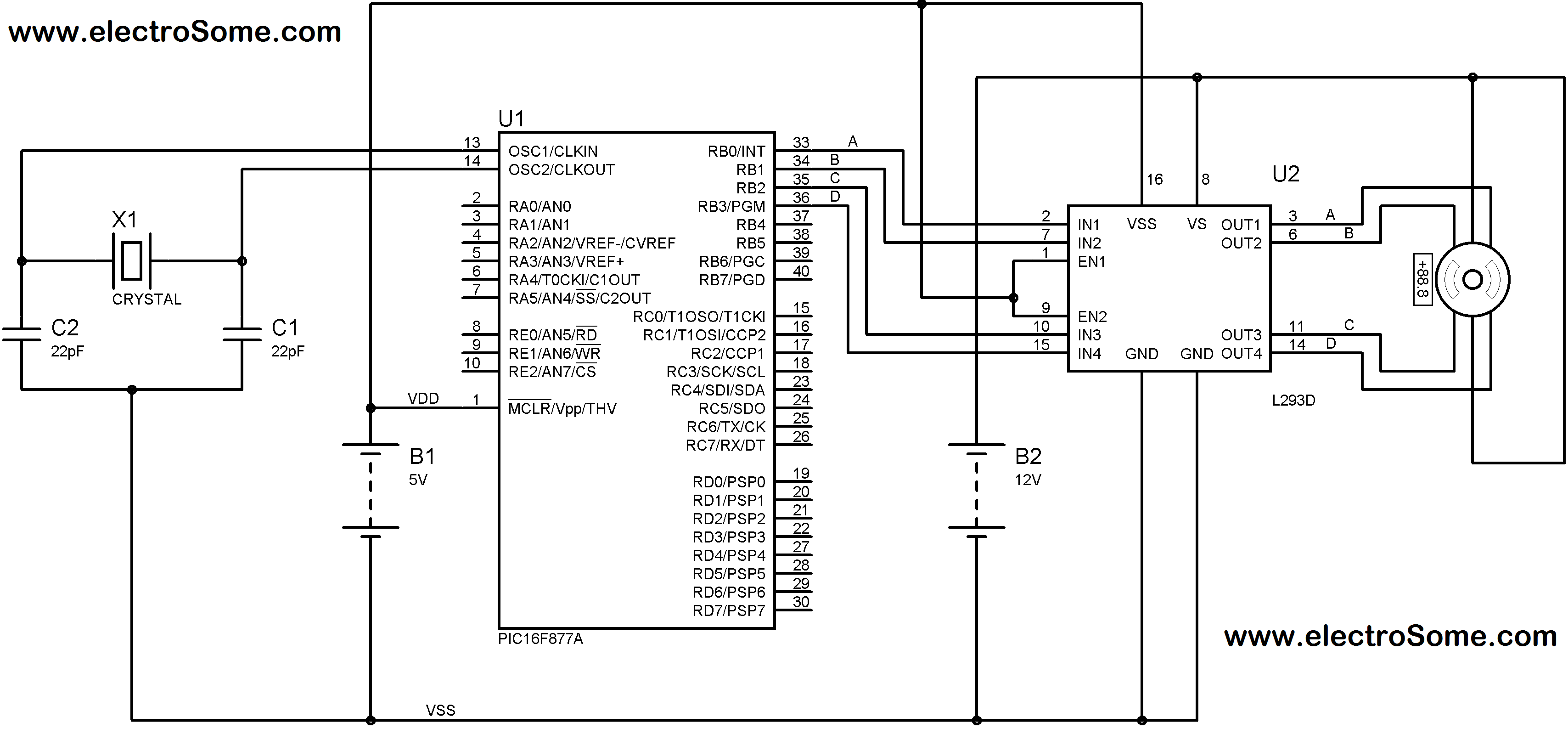

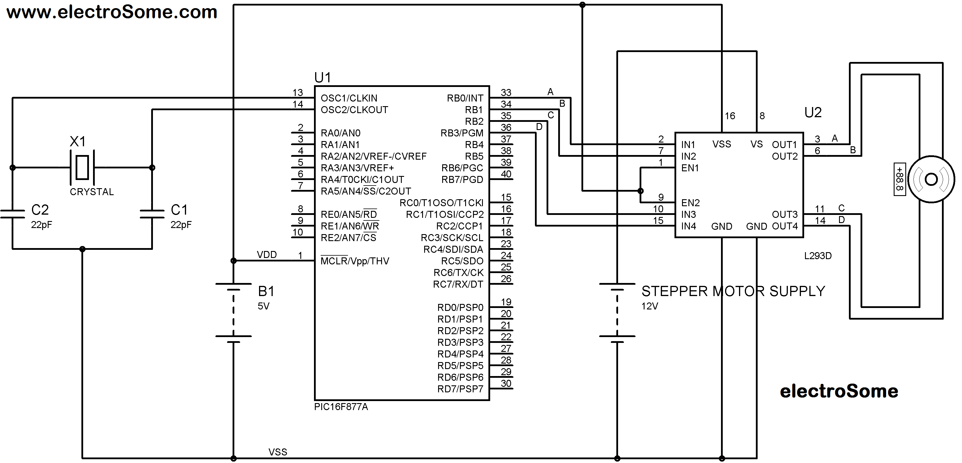

Interfacing Bipolar Stepper Motor with PIC Microcontroller
Bipolar Stepper Motor can be easily interfaced with PIC Microcontroller using L293D.
Circuit Diagram
Interfacing Bipolar Stepper Motor with PIC Microcontroller Circuit Diagram
MikroC Code
