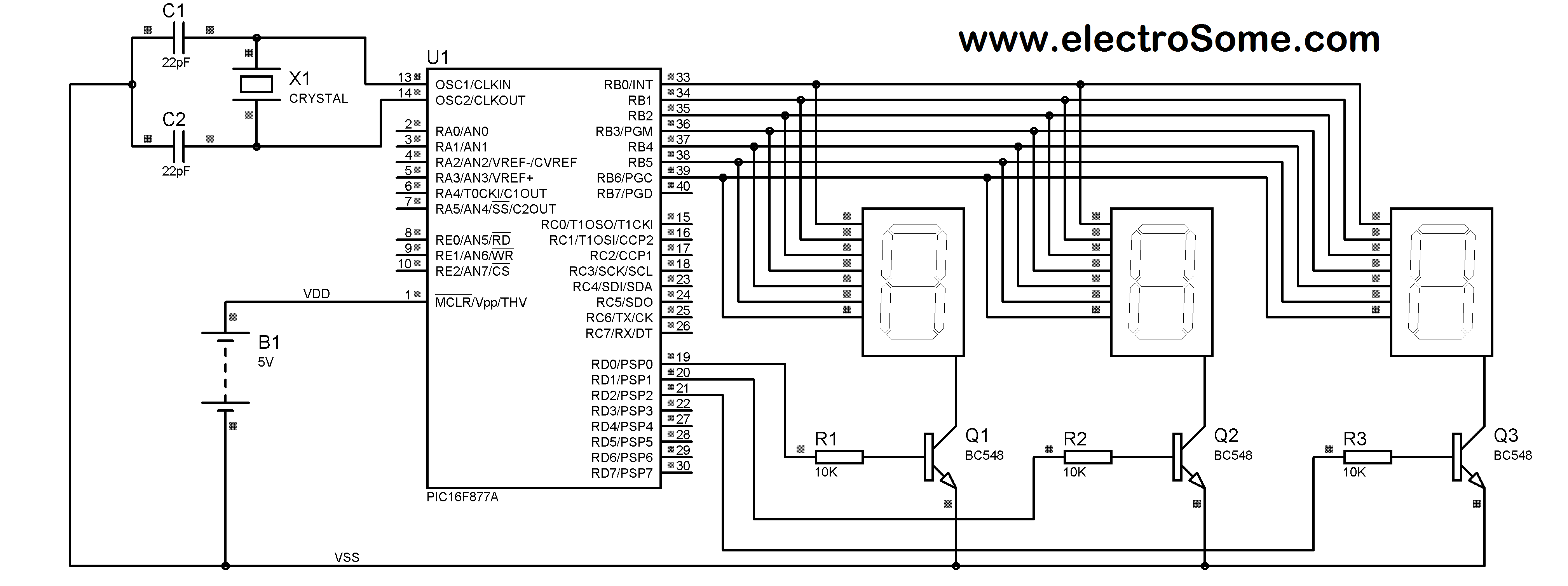

Circuit Diagram :
We have used Common Cathode Seven Segment Display in this example. Pins RB0 – RB6 are connected to the A – G of the display. This will count from 000 to 999.
MikroC Multiplexing Code:
PORTB = Hex(s%10);
 PORTD.F2 = 1;
 Delay_ms(10);
 PORTD.F2 = 0;
 PORTB = Hex((s/10)%10);
 PORTD.F1 = 1;
 Delay_ms(10);
 PORTD.F1 = 0;
 PORTB = Hex((s/100)%10);
 PORTD.F0 = 1;
 Delay_ms(10);
 PORTD.F0 = 0;
Where ‘s’ is an unsigned integer which counts from 000 to 999 and ‘Hex’ is a user defined function which will return Seven Segment Decoded Hex of a single digit.
First we send data through the data port, then we enable corresponding display and a appropriate delay is given. It is better to adjust the delay according to the situation after making your project.
