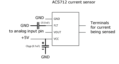

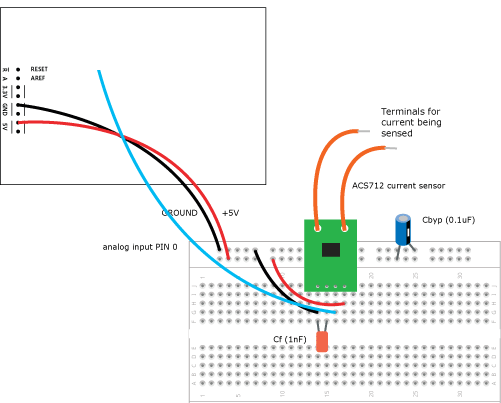

We need to first connect the ACS712 current sensor properly to an analogue input pin. The value read from the sensor is proportional to current measured on the sensing terminals.

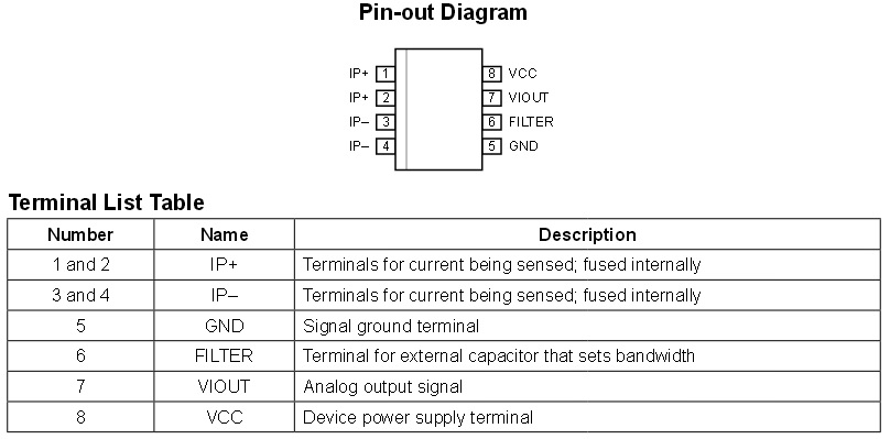

Pin diagram

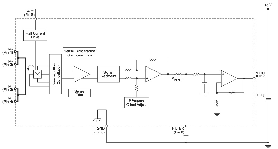

Internal diagram

How to connect ACS712 to a microcontroller
