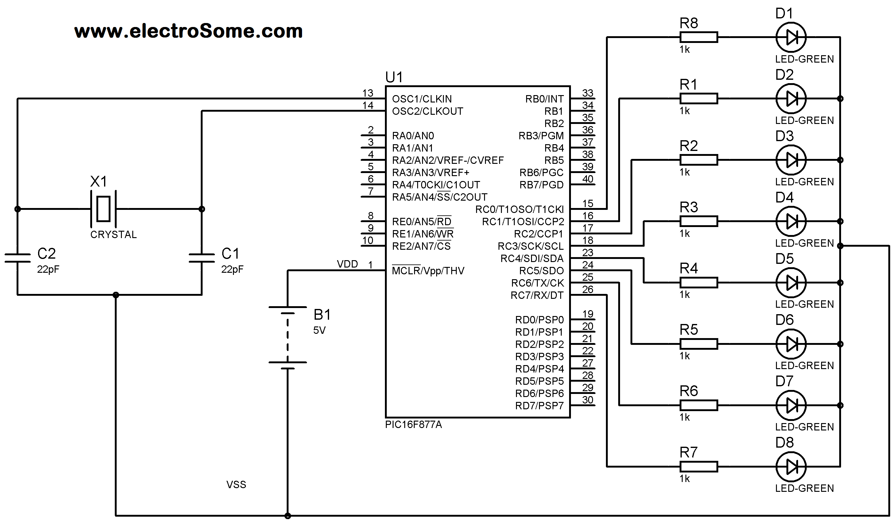

Circuit Diagram for Demonstration :
Using Internal EEPROM PIC Microcontroller
In this example we writes 00000001 to the first memory location, 00000010 to second, 000000100 to third etc sequentially up to 10000000. Then it is read sequentially and output through PORTC.
