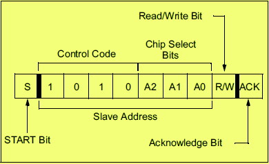

Control Byte is the first byte received by a slave device after receiving start signal from a master device. For 24C64 first 4 bits are control code (1010) for the device identification. Next 3 bits of the control byte are Chip Select Bits (A2, A1, A0). These bits allows us to connect up to eight 24XX64 devices on the same bus. The Chip Select Bits of control byte must be correspond to the logic levels of A2, A1, A0 of the device to be selected. The last bit of Control Byte is used to define the operation to be performed. It is set to 1 when read operation is to be performed and set to 0 when write operation is to be performed.

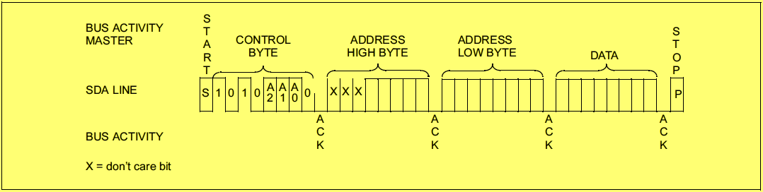

Byte Write
In this mode one byte is written at a time. After giving the START signal, the master send control byte, the control code (four bits), the chip select (three bits), and the R/W bit (which is a logic low) via I2C bus. This indicates the addressed device that, higher order address of memory location to be written will be follow after it has generated acknowledge signal. Thus next byte transmitted by master device will be higher order address and it will be stored in the address pointer of the 24XX64. The Least Significant Address byte will be followed after it has generated acknowledge signal. Then the master device will send data to written the address location. When the 24XX64 acknowledges, the master issues stop signal.
24XX64 EEPROM Byte Write
Note: Some delay should be given between sequential write processes otherwise write cycle may not occur.

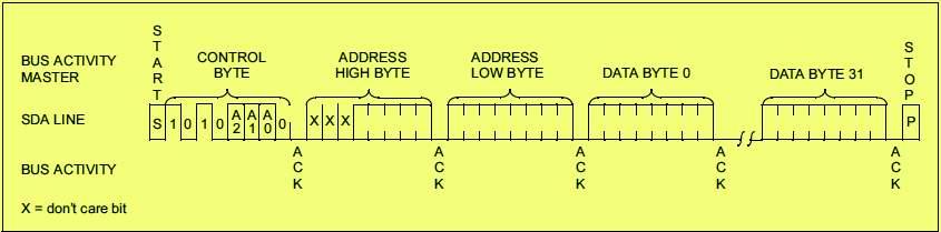

Page Write
Page write is similar Byte write, instead of generating STOP signal master transmits up to 31 additional bytes. These are temporarily stored in the on-chip page buffer and will be written in to memory after the master has given STOP signal. If the master sends more than 32 bytes, previously written data will be over written
24XX64 EEPROM Page Write

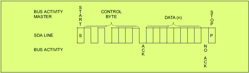

Current Address Read
The 24XX64 EEPROM contains an internal counter which maintains address of last memory location accessed, incremented by one internally. Thus upon receiving control byte with read/write control bit set to 1, 24XX64 issues acknowledge signal and transmits the 8-bit data word in the next memory location.
24C64 EEPROM Current Address Read

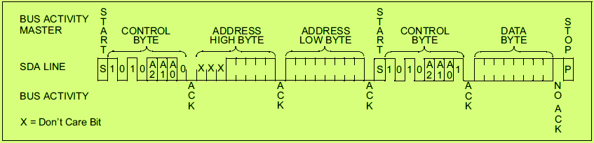

Random Read
Random read operation allows master to access any memory location in random manner. To perform this type of operation, we want to set the address in internal address counter to the required value. This is achieved by sending address to 24XX64 EEPROM as the part of write operation. After the acknowledge of this process, the master issues a START signal and control byte for read operation. Thus the required random memory location can be easily accessed.
24C64 EEPROM Random Read

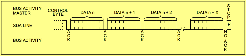

Sequential Read
Sequential Reading is initiated in a similar way as Random Read, except that after the 24XX64 EEPROM transmits first data byte master issues acknowledge signal instead of STOP signal in Random Read operation. This will direct 24XX64 EEPROM to send next data byte.
24C64 EEPROM Sequential Read

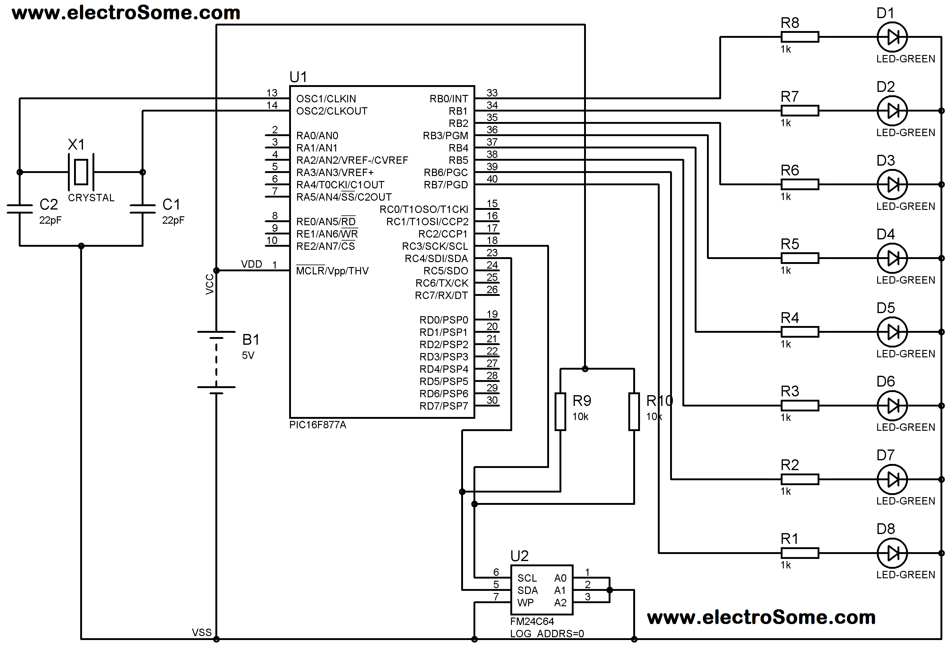

Circuit Diagram for Demonstration :
Interfacing External EEPROM with PIC Microcontroller
Note: VDD , VSS of the pic microcontroller and VDD, GND of 24C64 are not shown in the circuit diagram. Both VDD ‘s should be connected to +5V and VSS to GND.
In this example we writes 00000001 to the first memory location, 00000010 to second, 000000100 to third etc sequentially up to 10000000. Then it is read sequentially and output through PORTB.
To simulate this project in Proteus you may need to connect I2C Debugger. SCL and SDA of I2C Debugger should be connected in parallel to SCL and SDA of 24C64. I2C Debugger can be found where CRO can be found in Proteus.
