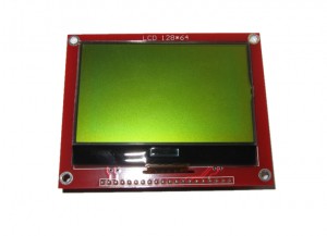

have already posted about Interfacing character LCD with PIC Microcontrollers. By using GLCD (Graphical LCD) we can present information in a better and user friendly way by using any patterns or shapes. Graphical LCDs are preferred where both character and graphical representation are required. Compared to Character LCD, GLCD is a bit complex and we need a powerful graphic library. MikroC PRO for PIC Microcontrollers provides powerful built in libraries for that.
MikroC Pro – Graphic LCD Library
MikroC Pro for PIC Microcontrollers provides built in library for interfacing 128×64 Graphical LCD with Samsung KS108/KS107 Controller. For the proper functioning of MikroC library we must define how we will connect GLCD to the PIC Microcontroller. This is achieved by defining a set of global variables with sbit datatype, which is used to address bit addressable registers. We must define the following global variables.

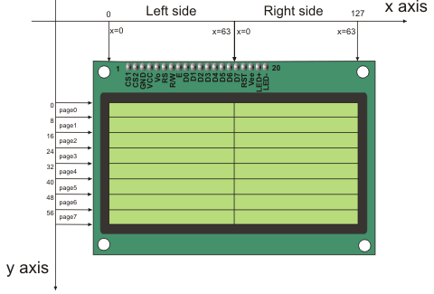

128×64 pixels in GLCD is divided into pages along Y axis and sides along X axis as shown below.
GLCD Pages and Sides

Glcd_Set_Side
This function is use to select GLCD side.
Prototype : void Glcd_Set_Side(unsigned short x_pos);
The unsigned variable x_pos determines the side. The valid values of the parameters are from 0 to 127. Values from 0 to 63 selects the left side and values from 64 to 127 selects the right side.

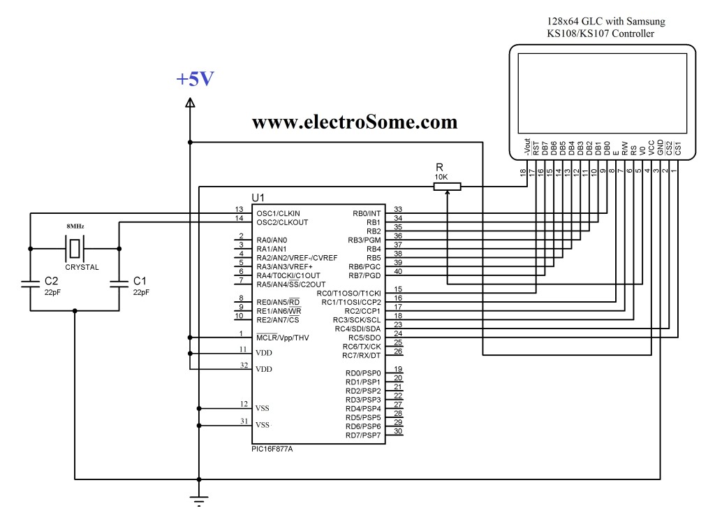

Circuit Diagram
Interfacing GLCD with PIC Microcontroller
Here is a sample MikroC program…
MikroC Program
