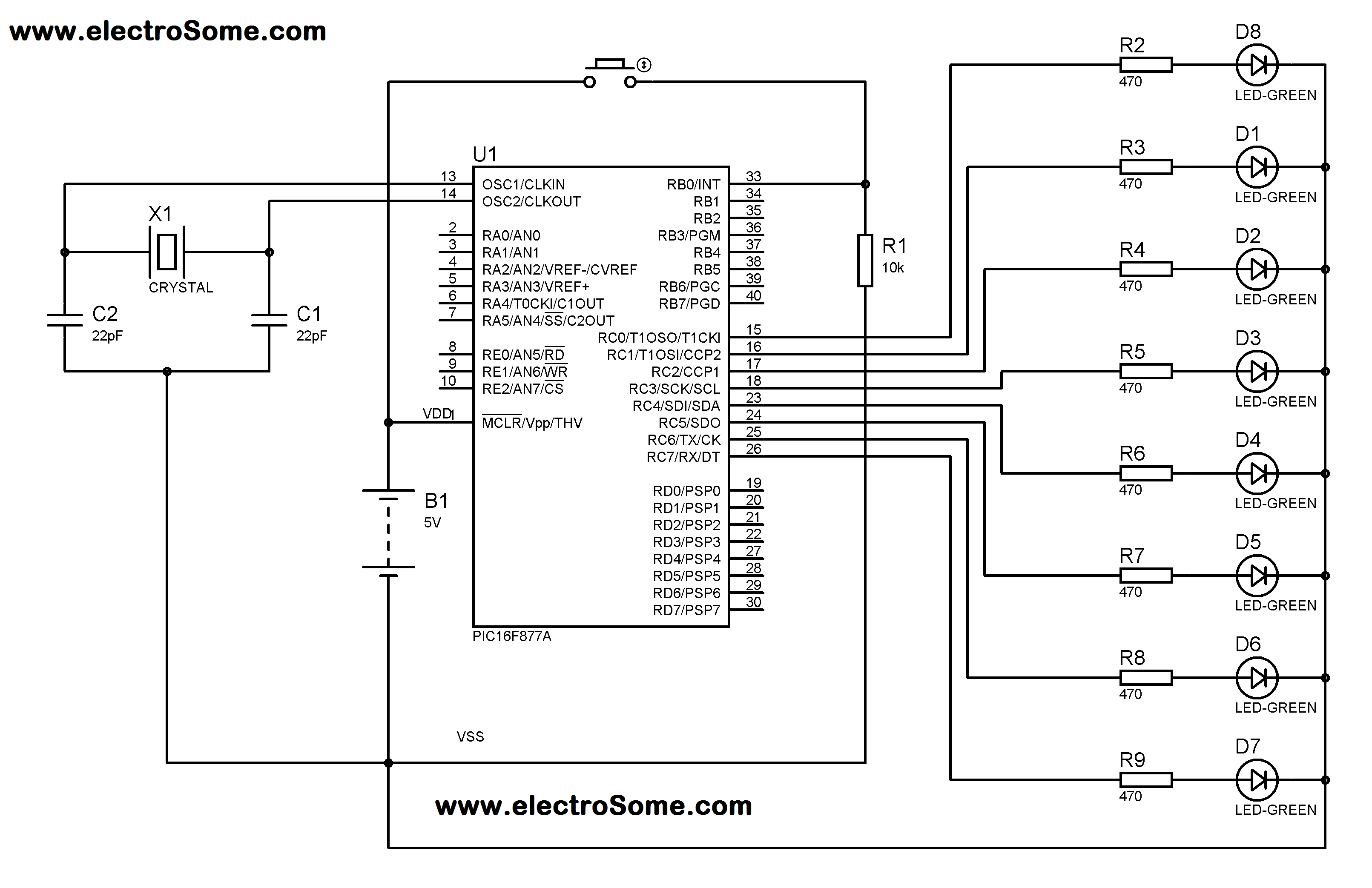

Circuit Diagram
Using Interrupts with PIC Microcontroller Circuit Diagram
Working
A push button switch is connected to the External Interrupt pin INT of the PIC Microcontroller. When this button is pressed, the microcontroller is interrupted and the ISR is executed. The ISR toggles the status of PORTC for 1 second.

In this ISR waiting for only RB0 interrupts for Toggle PORTC LEDs. Some time another interrupts can occur .Because Global interrupts are enable.(GIE=1)Therefore,In ISR must check for RB0 interrupts.
void interrupt() //  ISR
if(INTCON.INTF){
	INTCON.INTF=0; // Clear the interrupt 0 flag(Data sheet said "it must be cleared by software")
	PORTC=~PORTC; // Invert (Toggle) the value at PortD
	Delay_ms(1000); // Delay for 1 sec
I think this is useful usage of Interrupt Flag bit.
