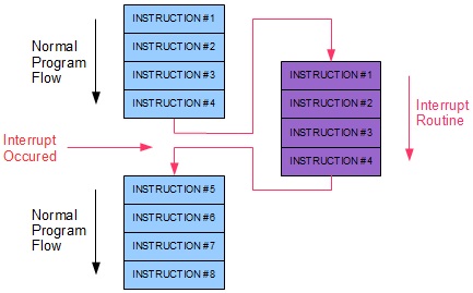

With the PIC, you can use two timer interrupts to trigger in a defined time interval to run separate codes. If you consider you previous program, you will see that you are already using threads with main function running in background while the interrupts trigger with a high priority by preempting (http://en.wikipedia.org/wiki/Preemption_%28computing%29) the main routine (idle routine).
Having delay loops will eat the CPU time unnecessarily. It is okay to use them in the idle loop but never inside interrupts. you need to service the interrupt routine as soon as possible by enabling some flags to be processed at the main loop.
