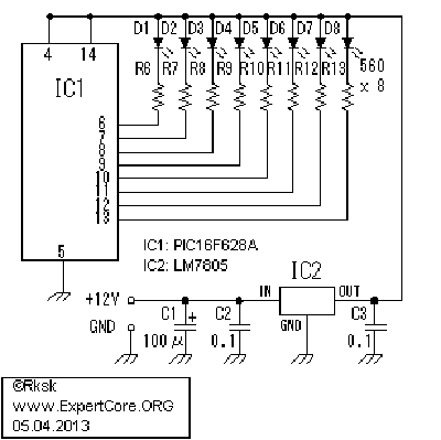

Post by Rksk » Sat May 04, 2013 7:28 pm
01. PIC programmer ????

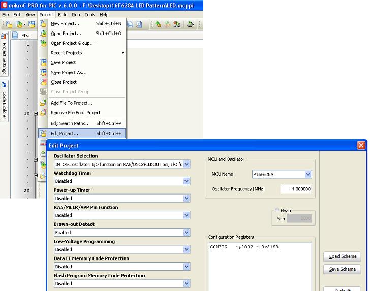

02. MikroC IDE ??
PIC programmer ????? ???? ??? ???? ???? ?? ???????????????????? ?? ?? ???????. ????? CD write ???? ???. ? ???? ???? ????? ????? ?????? ???? JDM programmers. ?? ?????? ??? ????? ????????? Serial port ?? ???? ??? ???? ???? ?????? ??? ??? ????????? ??. ????? USB ???? ??????? ??? PICKIT2 ??? ?????? ????????? ???? ?????? ???????.
? ??? MikroC IDE ?? ??????? ?????? ??????? http://www.mikroe.com/mikroc/pic/ ???????.
???? ??? ????? ??? ????????. ?? ?????? ???????? ?????? PIC16F628A ???? MicroChip PIC ?????? ???? ???????????????????? ??. ???? ???? 18?? ????? ??? ??? ??????? 180?? ??? ??????.
?? ???? ???? ???? ???? ????. ?? ???????? ????? ?????? ???? ????. C ?????? ????? ???? ??? ??? ??? ???? ??????.

int i; ??? ??? ????? ?????? ??? ??? C ????? ???????
void main(){
????? ??? ????? ???? ?????? ??? ??? ??????? ?????? ????? ?????. (???? ??? ???? ??? ???? function ???? ????? ???? ??)
TRISB = 0; ?????? ?????? PORTB ???? ???? 8? output ?????? ???? ??? ??.
PORTB = 0; ?????? ?????? PORTB ???? ???? 8? off ???????? ??? ??.
do
}while(1);
for (i = 0; i < 6; i++)
      PORTB = 1;
      Delay_ms(100);
      do
       PORTB = PORTB<<1;
       Delay_ms(100);
      }while(!PORTB.B7);
      PORTB = 0b10000001;
      Delay_ms(150);
      PORTB = 0b01000010;
      Delay_ms(150);
      PORTB = 0b00100100;
      Delay_ms(150);
      PORTB = 0b00011000;
      Delay_ms(150);
????? ?????? {} ????? ??? ????? ????? ???? ?? ??? ???? ??? ??? ????? ??????????? ???? ??. ?? ??? ????? ?????? ??? ??? ?????? ??? 6?? ??????. ?? ??? ?????? ?????? ?? ???????? ??? ??? ???? ?????? ???? ???? ???? ?? ????? ????? ???????.
???? ???? PORTB = 0b10000001; ???? ??? ?????. 0b10000001 ??????? 10000001 ???? ???? ????? ???????? C ???? ???? ?????. ???? 1,0 ????? ?????? PORTB ?????? 8 (PIC ??? ??? 6???13 ????? ???? 8), on/off ?????.
PORTB = 0b00000001; ???? ???????? RB0 (6???? ???? ??) ?????? ??? ????.
PORTB = 0b10000000; ???? ???????? RB7 (13???? ???? ??) ?????? ??? ????.
PORTB = 0b10100000; ???? ???????? RB7 ?? RB5(13 ?? 11 ???? ???) ?????? ??? ????.
? ?????? 1,0 ????? ???????? ?? ??????? output8 ????? ?????? ???????.
Delay_ms(150); ????? ?????? ???? ????? 150 ?????? ????? ???????. ? ??????? ??? ????? ???????? ????? ?????? outputs ??? ?????? ?????. ???? ????? 150?? ????? ??? ???? ??? ?????? ???. ????? ??? ?????? outputs ????? ???? ???? ?? ???? ???? ????? ????????. 150 ?????? ???? ?? ???????? ??? ????? ???? ????? ?????? ???????.
    for (i = 0; i < 10; i++)
      PORTB = 0b00001111;
      Delay_ms(250);
      PORTB = 0b11110000;
      Delay_ms(250);
????? ???????? ?????? ???? ????? 250?? ???? PIC ??? ??? 6???13 ????? ???? 8?? ???? ???? ??? ???????? ????? ?? ????? ???? ????? ??? ???? 10?????? ??????, ??? ????? ???.
?? ?? ?????? ???? ??? ????????. programing ???? ?????? ??? ???? ???? ??? :D ??? ?????? ??? ????? ?????? ???? ????? ???? ???.
?? ?????? ???? ?? ????? ??? ????? (??? ??? ???? ??????), ???? MikroC ??????????? ?? ?? ???????? test ?? ?????? ?? ?????? ?? Proteus file ??. zip file ?? ??? ?????? ??.

Post by Rksk » Sun May 05, 2013 6:50 pm
nwclasantha, ?????????? ????? ?????. :biggrin:
?? ???? ??? MikroC project settings ??? ?????, ????? ?? ?????? ? ??? ??????? ??.
[media]http://www.youtube.com/watch?v=hpFEQ0kC-6s[/media]
