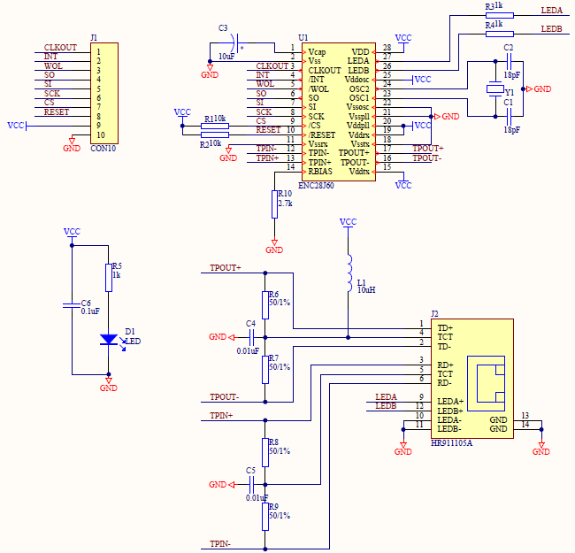

Schematic of the module is this.

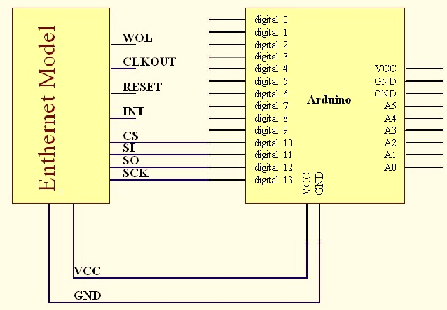

Connect the following pins carefully to the microcontroller.
ENC28J60_CONTROL_CS pin10
SPI_MOSI pin11
SPI_MISO pin12
SPI_SCK pin13
