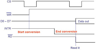

Signal control on ADC0804
1. Make CS = 0 and send a L-to-H pulse to pin WR to start the conversion.
2. Keep monitoring the INTR pin. If INTR is low, the conversion is finished and we can go to the next step. If INTR is high, keep polling until it goes low.
3. After the INTR has become low, we make CS = 0 and send a H-to-L pulse to the RD pin to get the data out of the ADC0804 IC chip.
Timing of the ADC

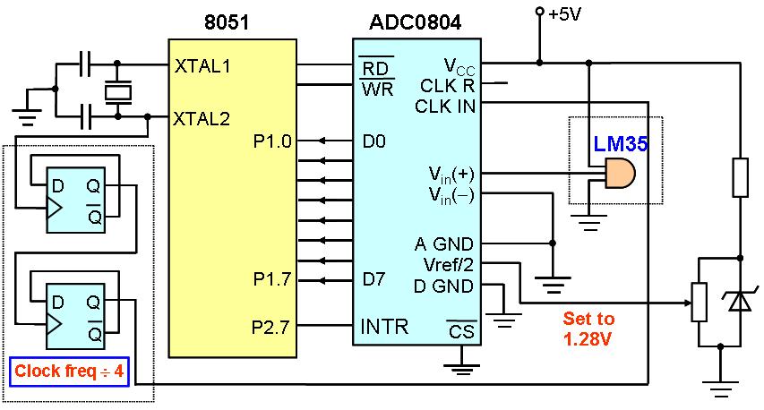

Example:
Write a program to monitor the INTR pin and bring the digital input value into register A. Then call a subroutine to display the input value on a 7-segment display. Do this continuously.
