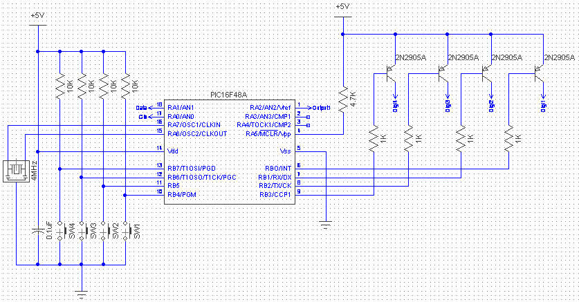

For this project, a Start/Stop switch(SW4) is toggle ON/OFF operation. when it's ON, the display will count down and will stop when it's zero or SW4 is press to stop operation. There are 2 switches for setting up time( SW2 and SW3 ), one for increasing second and another for increasing minute. You also can save current time into EEPROM and recall it later.

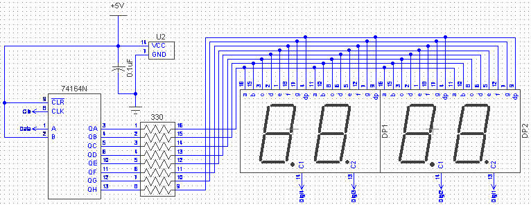

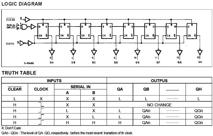

Because PIC16F84A does not have enough I/O ports; a 74164 serial-in, parallel-out is needed to expand for display. Each individual segment cathode is connected to separate 330 ohm current limiting resistors while the common anode of each display is connected to Collector pin of a PNP transistor. Data is send from RA1 pin of MCU to A pin of 74164 ; and RA0 pin is connected to CLK pin of 74164 to send shift clock signal. The figure below shown 74164 logic diagram and truth table.
Press SW4 switch to on - off the timer.
Press SW3 switch to increase second from 0 - 59.
Press SW2 switch to increase minute from 0 - 99.
Press and release SW1 switch to recall time from EEPROM. Press and hold SW1 for 2- 3 second for store current time into EEPROM.
