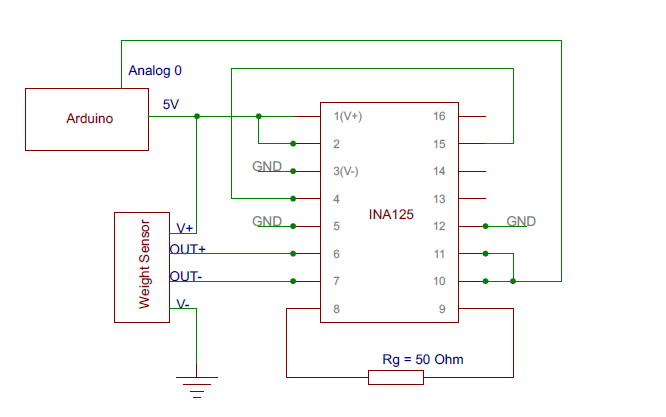

If you want to connect a load cell to a microcontroller, first you need to amply the signal. Here is a circuit diagram.
How to use Load Sensor with Microcontrollers
