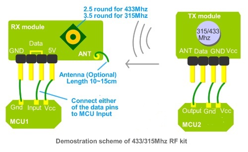

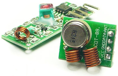

Transmitter and receiver modules are tuned to work correctly at 433.92MHz. Transmitter can be powered from 3 to 12V power supply while receiver accepts 5V. 5V is common for AVR microcontrollers so no problems with interfacing. Modules don't require addition components – just apply power and connect single data line to send information to/from and that's it. For better distances apply 30 – 35cm antennas. Modules use Amplitude-Shift Keying(ASK) modulation method and uses 1MHz bandwidth.
Transmitter
Receiver

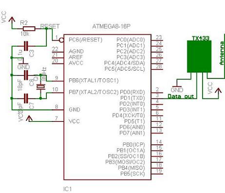

Transmitter program for AVR Atmega8:

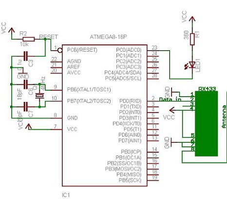

Receiver program code:

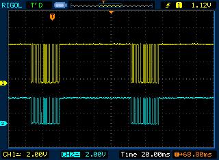

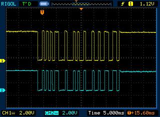

In the last pictures you can see data packets of 4 bytes seen on the oscilloscopes. Yellow signal is from transmission data line(TX) while blue is taken from receiver data line(RX):
Transmitted and received signals matches
There is no noise between data packages(ideal case)
