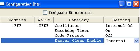

ec help.JPG (17.14 KiB) Viewed 8486 times
