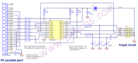

All documents and IDE for writing program is ready.. only thing left is a programmer, with which we are going to program our AVR. As we know almost all AVR comes with ISP (In System Programmable) ports. So you don't need any special hardware to program your AVR. Please see the link below for ISP programmer for AVR.
Download PonyProg - serial device programmer
Interfacing Schematic:
Note: Do not forget to run the setup after installing PonyProg.
Setup Information:
In interface setup, select parallel and then from the drop down select AVR ISP I/O.
slect the LPT Port (parallel port) available on your PC. Then click ok!
