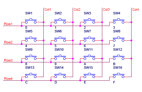

Constructing a Matrix Keypad
Construction of a keypad is really simple. As per the outline shown in the figure below we have four rows and four columns. In between each overlapping row and column line there is a key.
So keeping this outline we can construct a keypad using simple SPST Switches as shown below:
Now our keypad is ready, all we have to do is connect the rows and columns to a port of microcontroller and program the controller to read the input.

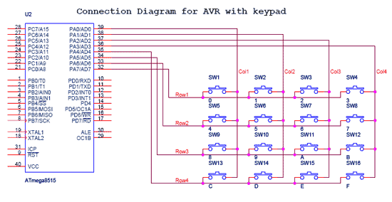

Keypad Connections with AVR Microcontroller
Circuit shown above is for demonstration and does not include any reset and crystal circuit. For practical use you need to have a reset circuit and crystal.

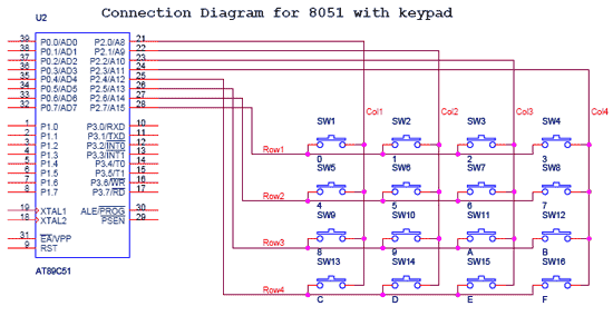

Keypad Connections with 8051 Microcontroller
