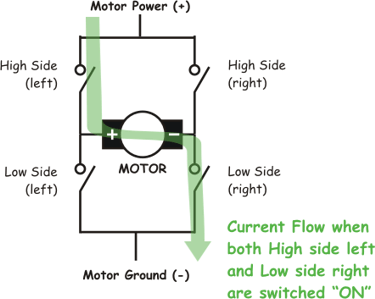

As you can see in the figure above there are four switching elements named as "High side left", "High side right", "Low side right", "Low side left". When these switches are turned on in pairs motor changes its direction accordingly. Like, if we switch on High side left and Low side right then motor rotate in forward direction, as current flows from Power supply through the motor coil goes to ground via switch low side right. This is shown in the figure below.

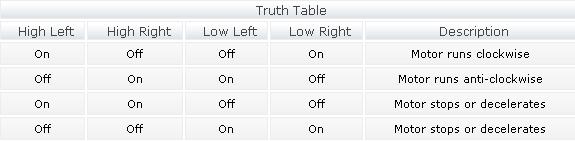

Similarly, when you switch on low side left and high side right, the current flows in opposite direction and motor rotates in backward direction. This is the basic working of H-Bridge. We can also make a small truth table according to the switching of H-Bridge explained above.

Now you might be thinking why i did not discuss the cases like High side left on and Low side left on or high side right on and low side right on. Clearly seen in the diagram, you don't want to burn your power supply by shorting them. So that is why those combinations are not discussed in the truth table.

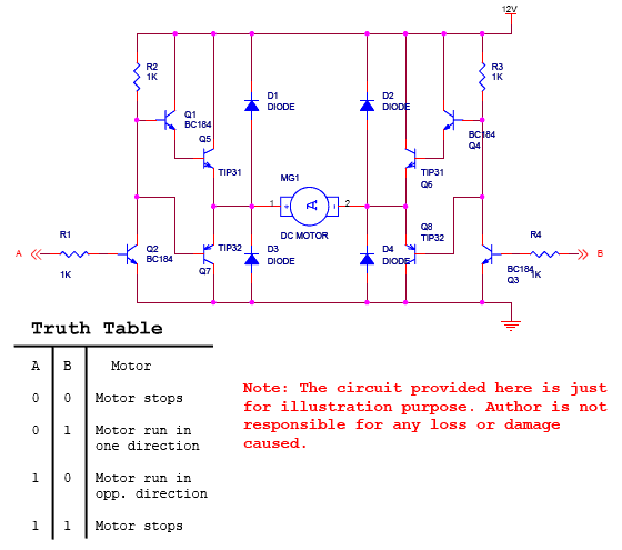

BJT H-Bridge

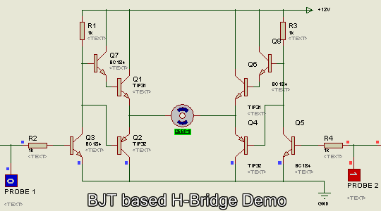

A simple H-bridge can be made with the help of Power BJTs like TIP31 and TIP32. An example and a working demo of this circuit is shown in the figure below.
BJT H-Bridge Demo

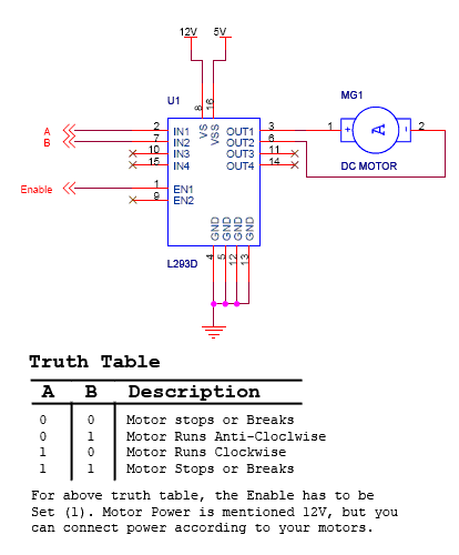

L293D Dual H-Bridge Motor Driver
L293D is a dual H-Bridge motor driver, So with one IC we can interface two DC motors which can be controlled in both clockwise and counter clockwise direction and if you have motor with fix direction of motion the you can make use of all the four I/Os to connect up to four DC motors. L293D has output current of 600mA and peak output current of 1.2A per channel. Moreover for protection of circuit from back EMF ouput diodes are included within the IC. The output supply (VCC2) has a wide range from 4.5V to 36V, which has made L293D a best choice for DC motor driver.
A simple schematic for interfacing a DC motor using L293D is shown below.
As you can see in the circuit, three pins are needed for interfacing a DC motor (A, B, Enable). If you want the o/p to be enabled completely then you can connect Enable to VCC and only 2 pins needed from controller to make the motor work.
As per the truth mentioned in the image above its fairly simple to program the microcontroller. Its also clear from the truth table of BJT circuit and L293D the programming will be same for both of them, just keeping in mind the allowed combinations of A and B. We will discuss about programming in C as well as assembly for running motor with the help of a microcontroller.
