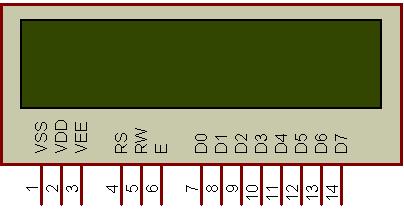

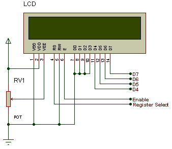

Pin Description
The most commonly used LCDs found in the market today are 1 Line, 2 Line or 4 Line LCDs which have only 1 controller and support at most of 80 charachers, whereas LCDs supporting more than 80 characters make use of 2 HD44780 controllers.
Most LCDs with 1 controller has 14 Pins and LCDs with 2 controller has 16 Pins (two pins are extra in both for back-light LED connections). Pin description is shown in the table below.
Figure 1: Character LCD type HD44780 Pin diagram
Pin NumberNameDescription
1VSSPower supply (GND)
2VCCPower supply (+5V)
3VEEContrast adjust
4RS0 = Instruction input, 1 = Data input
5R/W0 = Write to LCD module, 1 = Read from LCD module
6ENEnable signal
7D0Data bus line 0 (LSB)
8D1Data bus line 1
9D2Data bus line 2
10D3Data bus line 3
11D4Data bus line 4
12D5Data bus line 5
13D6Data bus line 6
14D7Data bus line 7 (MSB)

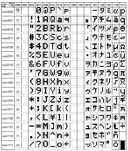

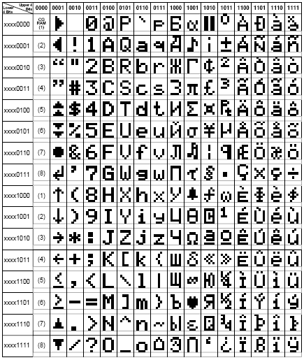

CGROM - Character Generator ROM
Now you might be thinking that when you send an ASCII value to DDRAM, how the character is displayed on LCD? so the answer is CGROM. The character generator ROM generates 5 x 8 dot or 5 x 10 dot character patterns from 8-bit character codes (see Figure 5 and Figure 6 for more details). It can generate 208 5 x 8 dot character patterns and 32 5 x 10 dot character patterns. User-defined character patterns are also available by mask-programmed ROM.
Figure 5: LCD characters code map for 5x8 dots
Figure 6: LCD characters code map for 5x10 dots
As you can see in both the code maps, the character code from 0x00 to 0x07 is occupied by the CGRAM characters or the user defined characters. If user want to display the fourth custom character then the code to display it is 0x03 i.e. when user send 0x03 code to the LCD DDRAM then the fourth user created charater or patteren will be displayed on the LCD.

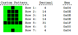

CGRAM - Character Generator RAM
As clear from the name, CGRAM area is used to create custom characters in LCD. In the character generator RAM, the user can rewrite character patterns by program. For 5 x 8 dots, eight character patterns can be written, and for 5 x 10 dots, four character patterns can be written. Later in this tutorial i will explain how to use CGRAM area to make custom character and also making animations to give nice effects to your application.

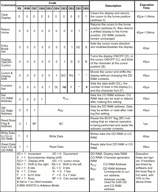

Commands and Instruction set
Only the instruction register (IR) and the data register (DR) of the LCD can be controlled by the MCU. Before starting the internal operation of the LCD, control information is temporarily stored into these registers to allow interfacing with various MCUs, which operate at different speeds, or various peripheral control devices. The internal operation of the LCD is determined by signals sent from the MCU. These signals, which include register selection signal (RS), read/write signal (R/W), and the data bus (DB0 to DB7), make up the LCD instructions (Table 3). There are four categories of instructions that:
  • Designate LCD functions, such as display format, data length, etc.
  • Set internal RAM addresses
  • Perform data transfer with internal RAM
  • Perform miscellaneous functions
Table 3: Command and Instruction set for LCD type HD44780
Although looking at the table you can make your own commands and test them. Below is a brief list of useful commands which are used frequently while working on the LCD.
NumberInstructionHexDecimal
1Function Set: 8-bit, 1 Line, 5x7 Dots0x3048
2Function Set: 8-bit, 2 Line, 5x7 Dots0x3856
3Function Set: 4-bit, 1 Line, 5x7 Dots0x2032
4Function Set: 4-bit, 2 Line, 5x7 Dots0x2840
5Entry Mode0x066
6Display off Cursor off (clearing display without clearing DDRAM content)0x088
7Display on Cursor on0x0E14
8Display on Cursor off0x0C12
9Display on Cursor blinking0x0F15
10Shift entire display left0x1824
12Shift entire display right0x1C30
13Move cursor left by one character0x1016
14Move cursor right by one character0x1420
15Clear Display (also clear DDRAM content)0x011
16Set DDRAM address or coursor position on display0x80+add*128+add*
17Set CGRAM address or set pointer to CGRAM location0x40+add**64+add**
Table 4: Frequently used commands and instructions for LCD
* DDRAM address given in LCD basics section see Figure 2,3,4
** CGRAM address from 0x00 to 0x3F, 0x00 to 0x07 for char1 and so on..
The table above will help you while writing programs for LCD. But after you are done testing with the table 4, i recommend you to use table 3 to get more grip on working with LCD and trying your own commands. In the next section of the tutorial we will see the initialization with some of the coding examples in C as well as assembly.

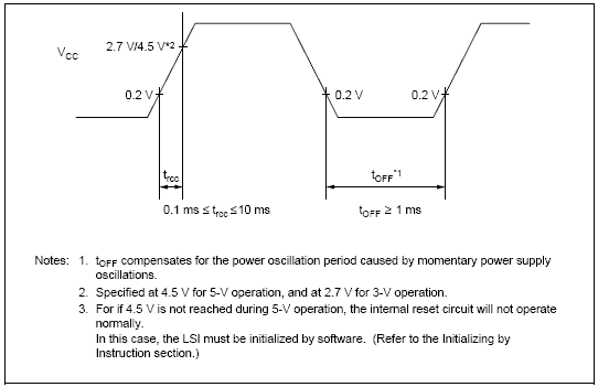

Note: If the electrical characteristics conditions listed under the table Power Supply Conditions Using Internal Reset Circuit are not met, the internal reset circuit will not operate normally and will fail to initialize the HD44780U. For such a case, initialization must be performed by the MCU as explained in the section, Initializing by Instruction.
As mentioned in the Note, there are certain conditions that has to be met, if user want to use initialization by internal reset circuit. These conditions are shown in the Table 5 below.
Table 5: Power Supply condition for Internal Reset circuit
Figure 7 shows the test condition which are to be met for internal reset circuit to be active.
Figure 7: Internal Power Supply reset
Now the problem with the internal reset circuit is, it is highly dependent on power supply, to meet this critical power supply conditions is not hard but are difficult to achieve when you are making a simple application. So usually the second method i.e. Initialization by instruction is used and is recommended most of the time.

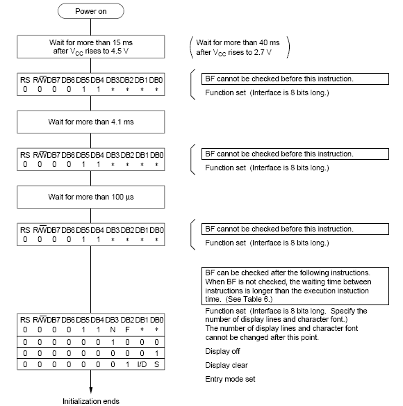

Initialization by instructions
Initializing LCD with instructions is really simple. Given below is a flowchart that describes the step to follow, to initialize the LCD.
Figure 8: Flow chart for LCD initialization
As you can see from the flow chart, the LCD is initialized in the following sequence...
  1. Send command 0x30 - Using 8-bit interface
  2. Delay 20ms
  3. Send command 0x30 - 8-bit interface
  4. Delay 20ms
  5. Send command 0x30 - 8-bit interface
  6. Delay 20ms
  7. Send Function set - see Table 4 for more information
  8. Display Clear command
  9. Set entry mode command - explained below
The first 3 commands are usually not required but are recommended when you are using 4-bit interface. So you can program the LCD starting from step 7 when working with 8-bit interface. Function set command depends on what kind of LCD you are using and what kind of interface you are using (see Table 4 in LCD Command section).

Setting cursor position on LCD
To set the cursor position on LCD, we need to send the DDRAM address...
Bit76543210
1AD6AD5AD4AD3AD2AD1AD0
The seventh bit is always 1, and bit 0 to 7 are DDRAM address (See the introduction section of LCD). so if you want to put the cursor on first position the address will be '0000000B' in binary and 7th bit is 1. so address will be 0x80, so for DDRAM all address starts from 0x80.
For 2 line and 16 character LCD. The address from 0x80 to 0x8F are visible on first line and 0xC0 to 0xCF is visible on second line, rest of the DDRAM area is still available but is not visible on the LCD, if you want to check this thing, then simply put a long sting greater than 16 character and shift the entire display, you will see all the missing character coming from the back.. this way you can make scrolling line on LCD (see more on shifting display in commands section).

CGRAM and Character Building
As already explained, all character based LCD of type HD44780 has CGRAM area to create user defined patterns. For making custom patterns we need to write values to the CGRAM area defining which pixel to glow. These values are to be written in the CGRAM address starting from 0x40. If you are wondering why it starts from 0x40? Then the answer is given below.
Bit 7 is 0 and Bit 6 is 1, due to which the CGRAM address command starts from 0x40, where the address of CGRAM (Acg) starts from 0x00. CGRAM has a total of 64 Bytes. When you are using LCD as 5x8 dots in function set then you can define a total of 8 user defined patterns (1 Byte for each row and 8 rows for each pattern), where as when LCD is working in 5x10 dots, you can define 4 user defined patterns.
Lets take an of building a custom pattern. All we have to do is make a pixel-map of 7x5 and get the hex or decimal value or hex value for each row, bit value is 1 if pixel is glowing and bit value is 0 if pixel is off. The final 7 values are loaded to the CGRAM one by one. As i said there are 8 rows for each pattern, so last row is usually left blank (0x00) for the cursor. If you are not using cursor then you can make use of that 8th row also. so you get a bigger pattern.
To explain the above explanation in a better way. I am going to take an example. Lets make a "Bell" pattern as shown below.
Now we get the values for each row as shown.
Bit43210Hex
Row1001000x04
Row2011100x0E
Row3011100x0E
Row4011100x0E
Row5111110x1F
Row6000000x00
Row7001000x04
Row8000000x00
We are not using row 8 as in our pattern it is not required. if you are using cursor then it is recommended not to use the 8th row. Now as we have got the values. We just need to put these values in the CGRAM. You can decided which place you want to store in. Following is the memory map for custom patterns in CGRAM.

The above routine will create bell character at pattern location 2. To display the above generated pattern on LCD, simply load the pattern location (0,1,2,...7) and call the LCD_senddata subroutine.

LCD in 4-bit Mode - Introduction
Till now whatever we discussed in the previous part of ths LCD tutorial, we were dealing with 8-bit mode. Now we are going to learn how to use LCD in 4-bit mode. There are many reasons why sometime we prefer to use LCD in 4-bit mode instead of 8-bit. One basic reason is lesser number of pins are needed to interface LCD.
In 4-bit mode the data is sent in nibbles, first we send the higher nibble and then the lower nibble. To enable the 4-bit mode of LCD, we need to follow special sequence of initialization that tells the LCD controller that user has selected 4-bit mode of operation. We call this special sequence as resetting the LCD. Following is the reset sequence of LCD.
  • Wait for abour 20mS
  • Send the first init value (0x30)
  • Wait for about 10mS
  • Send second init value (0x30)
  • Wait for about 1mS
  • Send third init value (0x30)
  • Wait for 1mS
  • Select bus width (0x30 - for 8-bit and 0x20 for 4-bit)
  • Wait for 1mS
The busy flag will only be valid after the above reset sequence. Usually we do not use busy flag in 4-bit mode as we have to write code for reading two nibbles from the LCD. Instead we simply put a certain amount of delay usually 300 to 600uS. This delay might vary depending on the LCD you are using, as you might have a different crystal frequency on which LCD controller is running. So it actually depends on the LCD module you are using. So if you feel any problem running the LCD, simply try to increase the delay. This usually works. For me about 400uS works perfect.
LCD connections in 4-bit Mode
Above is the connection diagram of LCD in 4-bit mode, where we only need 6 pins to interface an LCD. D4-D7 are the data pins connection and Enable and Register select are for LCD control pins. We are not using Read/Write (RW) Pin of the LCD, as we are only writing on the LCD so we have made it grounded permanently. If you want to use it.. then you may connect it on your controller but that will only increase another pin and does not make any big difference. Potentiometer RV1 is used to control the LCD contrast. The unwanted data pins of LCD i.e. D0-D3 are connected to ground.
