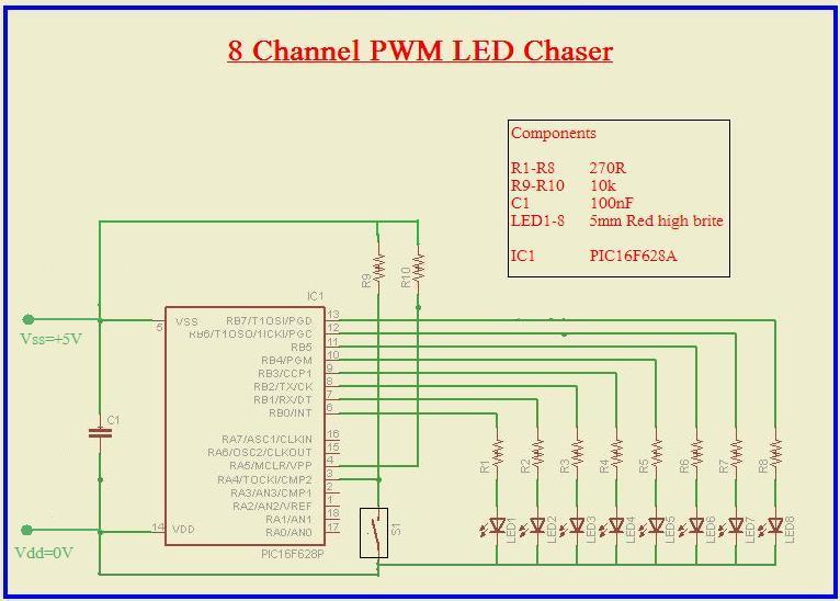

This neat little circuit provides 8 LEDs directly driven from the PIC along with a single mode control switch. The firmware elsewhere on this page drives the LEDs with a 5 bit PWM signal providing each of the 8 LED channels with four levels of intensity; off, dim, mid, bright. A number of sequences are programmed into the firmware to provide some interesting visual effects and chase sequences, including the classic effect seen on the car in the Knight Rider TV series.

Schematic

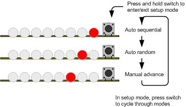

The program has three modes of operation.
1.Manual mode will run the same sequence continually. When the switch is pressed it will skip to the next sequence in program memory.
2.In auto-sequential mode, the program runs through each sequence in program memory until it reaches the end of all defined sequences at which point it restarts from the first one.
3.In random mode the program selects sequences randomly.
When the code is running in any mode, a short press of the switch will make the controller skip to the next sequence.
To enter setup mode, press and hold the switch. Once it enters setup mode one of three LEDs will light indicating the current run mode. A short press of the switch cycles through the three modes. When the desired run mode has been selected, press and hold the switch to exit setup and return to run mode.
The current mode and selected sequence are automatically saved to the PICs internal non-volatile EEPROM memory 10 seconds after the last switch press. When the LED chaser is next powered up it will load and start running using the saved mode and sequence.

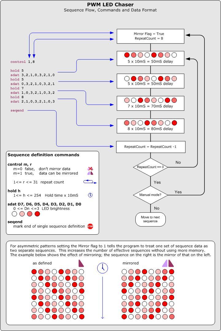

Description of Sequence Data
The data used to create the sequences is held in a separate include file. You can add, remove or edit this data to create your own chaser sequences.
To make the creation of the data file easier a set of macros have been defined which are used to create the sequence data. This is described in the below image.
If you download the source code and look at the file named pwmc_SeqData.inc you can see the data used in the project. You might want to edit this file as a starting point to create some sequences of your own.
Notes:
1.In manual mode, when the repeat count reaches zero it will restart the same sequence, to advance to the next sequence press the switch.
2.In Random mode it will the select a random sequence number to run. If the Mirror flag is true for that sequence it will also randomly choose to mirror the data or not.
3.In auto-sequential mode if the Mirror flag is true it will run the sequence and then repeat it with the data mirrored.
