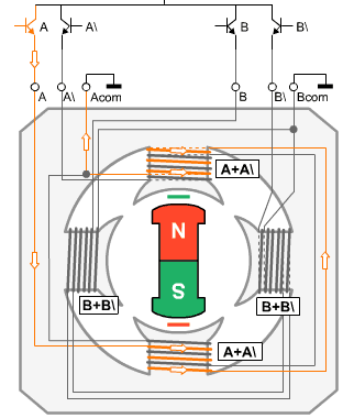

Working of Stepper Motor

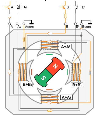

Now lets discuss the operation principle of a stepper motor. When we energize a coil of stepper motor, The shaft of stepper motor (which is actually a permanent magnet) align itself according to poles of energized coil. So when motor coils are energized in a particular sequence, motor shaft tend to align itself according to pole of coils and hence rotates. A small example of energizing operation is given below.
You can see in the example, when coil "A" is energized, A north-south polarity is generated at "A+A\" as shown in the figure above and magnetic shaft automatically align itself according to the poles generated. When the next coil is energized the shaft again align itself and take a step. Hence the working principle.
We have seen that to make the stepper motor work, we need to energize coil in a sequence. The explanation and generation of the sequence is explained in the next section of the tutorial.

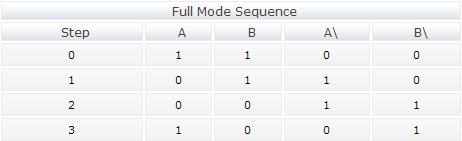

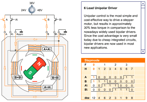

Full Step Sequence
In the full step sequence, two coils are energized at the same time and motor shaft rotates. The order in which coils has to be energized is given in the table below.
The working of the full mode sequence is given in the animated figure below.

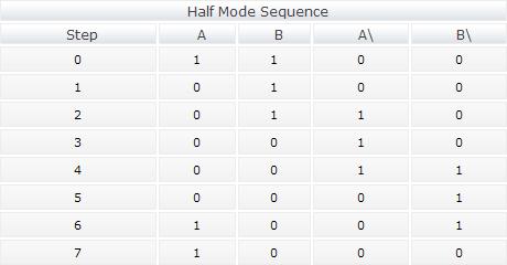

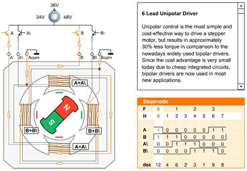

Half Step Sequence
In Half mode step sequence, motor step angle reduces to half the angle in full mode. So the angular resolution is also increased i.e. it becomes double the angular resolution in full mode. Also in half mode sequence the number of steps gets doubled as that of full mode. Half mode is usually prefer over full mode. Table below shows the pattern of energizing the coils.

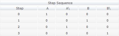

Step Sequence for 2-wire control of Unipolar stepper motor
As seen in above explanation, In every step of the sequence, two wires are always set to opposite polarities. Because of this, it's possible to control steppers with only two wires instead of four, with a slightly more complex circuit. The stepping sequence is the same as it is for the two coils A and B, and the opposite polarity value is given to A\ and B\. The sequence is given in the table below:

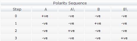

Step Sequence for Bipolar stepper motor
Bipolar motor has simpler construction. It has two windings with no center taps and a permanent magnet at the center just like unipolar stepper motors. Being simpler in construction, the stepping sequence is a little complex, as the power for both the coils has to be controlled in such a way that the polarity of the poles get reversed. This polarity sequence is shown in the table below.
The above polarity sequence can be interpreted in terms of logic levels for microcontroller by activating one coil at a time as shown in the table below.

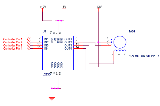

Connecting Unipolar stepper using L293D
As you see in the circuit above the four pins "Controller pin 1",2,3 and 4 will control the motion and direction of the stepper motor according to the step sequece programmed in the controller.

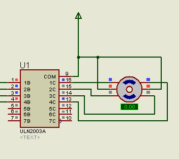

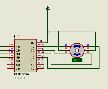

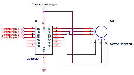

Connecting Unipolar stepper using ULN2003/2004
As already discussed in case of L293D, Here in this circuit too the four pins "Controller pin 1",2,3 and 4 will control the motion and direction of the stepper motor according to the step sequence sent by the controller.

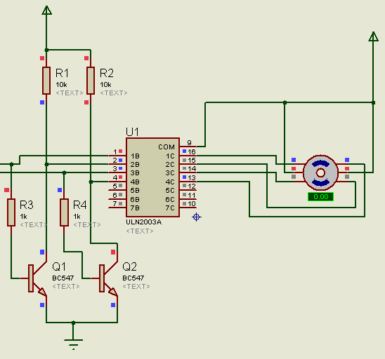

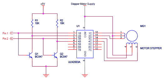

2-wire connection for Unipolar Stepper Motor
We have seen the generally used 4-wire connection method for interfacing unipolar stepper motor, but we can simplify the design to make controller use less pins with the help of 2-wire connection method. The circuit for 2-wire connection is shown below.

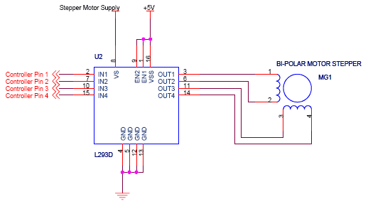

Connecting Bipolar Stepper Motor
As we have studied that, Bi-polar stepper motors has 2 different coils. The step sequence for Bipolar stepper motor is same as that of unipolar stepper motors. The driving circuit for this require an H-Bridge as it allows the polarity of the power applied to be controlled independently. This can be done as shown in the figure below:
