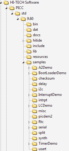

When it says C, it's C. Whatever C example in the world will work with it. The speciality in a embedded compiler other than a general purpose C compiler is the set of in-built libraries for hardware calls (for particular set of chips). So those must be covered by the embedded compiler. If you take the examples folder in HiTECH C compiler, it covered almost every important aspect in the hardware (As shown in the following figure). That's all we expect form an embedded compiler.
