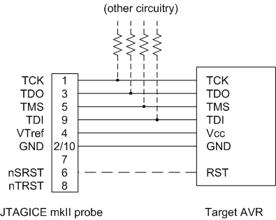

The following is the pin configuration i have on the programmer, [JTAG]

I think that I am not going to be able to use JTAG debugging with this board. Since board has the ISP header, not the JTAG header.
Correct. That's the case. JTAG and ISP are two different interfaces. If your Dev. Board has ISP, better use an ISP programmer. As you said with ISP, it is not possible to debug.
Another option is to take the JTAG pins out of the chip and use your JTAG programmer. It is easy to do experiments when you have the debugging facility as a beginner. Read http://support.atmel.no/knowledgebase/a ... erface.htm

Thanks Neo. I tried connecting to the JTAG by manually soldering(By referring to the ATMega16 datasheet, and your diagram). But it looks like that the JTAG adapter is no longer working. The target board boots up normally when connected to the JTAG adapter. I am not sure if this is normal. But the AVRStudio does not detect the adapter. It detected the adapter first time i tried it and AVRStudio said that "there is no power for the target" (I did not have anything at the other end). Now it is not detecting anything.

Based on symptoms. it looks like the JTAG is gone. However it would have been better if you could have a JTAG at the beginning stage.
