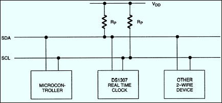

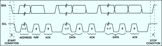

It 's importance to have some knowledge about I2C when we want to interface with DS1307because the DS1307 operates as a I2C slave device on the serial bus. Access is obtained by(see fig. 3)implementing a START condition and providing a device identification code followed by a register address. Subsequent registers can be accessed sequentially until a STOP condition is executed. The START and STOP conditions are generated using the low level drives, SEND_START and SEND_STOP found in the attached microcontroller code. Also the subroutines SEND_BYTE and READ_BYTE provide the 2–wire handshaking required for writing and reading 8–bit words to and from the DS1307.For more information about I2C see at Phillips web site.
Figure 2. I2C BUS CONFIGURATION
Figure 3. DATA TRANSFER ON 2–WIRE SERIAL BUS
2-wire timing interface (See Fig.3)
Start data transfer: A change in the state of the data line from high to low, while the clock line is high, defines a START condition.
Stop data transfer: A change in the state of the data line from low to high, while the clock line is high, defines the STOP condition.
Data valid: The state of the data line represents valid data when, after a START condition, the data line is stable for the duration of the high period of the clock signal. The data on the line must be changed during the low period of the clock signal. There is one clock pulse per bit of data. Each data transfer is initiated with a START condition and terminated with a STOP condition. The number of data bytes transferred between the START and the STOP conditions is not limited, and is determined by the master device. The information is transferred byte–wise and each receiver acknowledges with a ninth bit.
Acknowledge: Each receiving device, when addressed, is obliged to generate an acknowledge after the reception of each byte. The master device must generate an extra clock pulse which is associated with this acknowledge bit. A device that acknowledges must pull down the SDA line during the acknowledge clock pulse in such a way that the SDA line is stable low during the high period of the acknowledge related clock pulse. Of course, setup and hold times must be taken into account. A master must signal an end of data to the slave by not generating an acknowledge bit on the last byte that has been clocked out of the slave. In this case, the slave must leave the data line high to enable the master to generate the STOP condition.

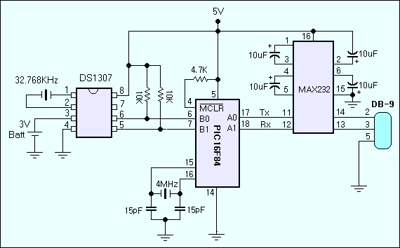

Interfacing with PIC
There are two method to programming to interface I2C devices with PICMicro :Software I2C and Hardware I2C interface.But,here is only software I2C which programming with CCS. The DS1307 signal pin must pulled up with external resistor about 10K to ensure logic level.
The software will reads all data from RTC then send to PC via RS232 interface with buad rate 9600,8,N,1. In main loop just read and send data every 500 mS to refresh Hyper terminal program.
Figure 4.Connecting DS1307 with PIC for this example
In this example I use Hyper terminal sotware to show all data received from DS1307 and you can use other terminal programs that you can find.
CCS code

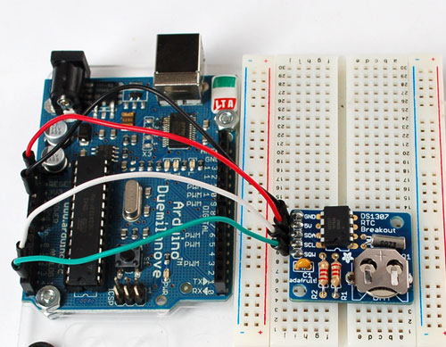

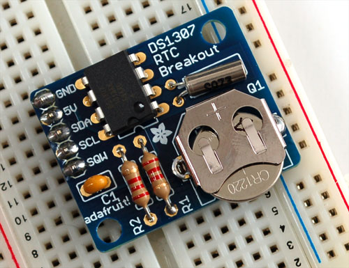

See this image with the inbuilt battery.
