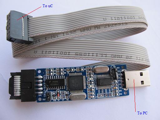

I checked ebay, but those programmers seems to be with FTDI and a RS-232 to TTL Level coversion with some uC too.. I have a mobile phone cable with has Tx and Rx pins. I cut it out from a Nokia DKU-5 cable and connected to a Sony Ericsson K600i to flash it. I think this cable is either 3.3V or 5V. Most probably 3.3V (or 3V). I know for sure that it can be used to write my router's flash via JTAG.
And I have another cable with PL2303->[TTL lvl conversio]-->phone .
I am going to have to try this cable out by my self. And I might fry a chip in the process or it might not work at all.
If I run the MCU at about 3V. I guess that It might work. But I am not sure. :D
Re: What are the Atmel Atmega MCUs found in SL
Post by Neo » Fri Dec 03, 2010 11:09 am
I'm not sure about your problem. Since the interface to PC is USB, you don't have to worry about voltage levels of the programmer, isn't it? The output jack of the programmer (JTAG) can be directly interfaced to your micro. No consideration on power levels required there too.

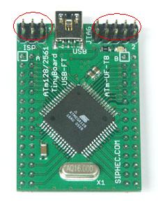

Mostly people leave this header in their production board as well so that they can do in-circuit programming and debugging in the production environment.
See this production board. They have left both ISP and JTAG ports so whenever they want they can programme or debug with the custom hardware peripherals.
