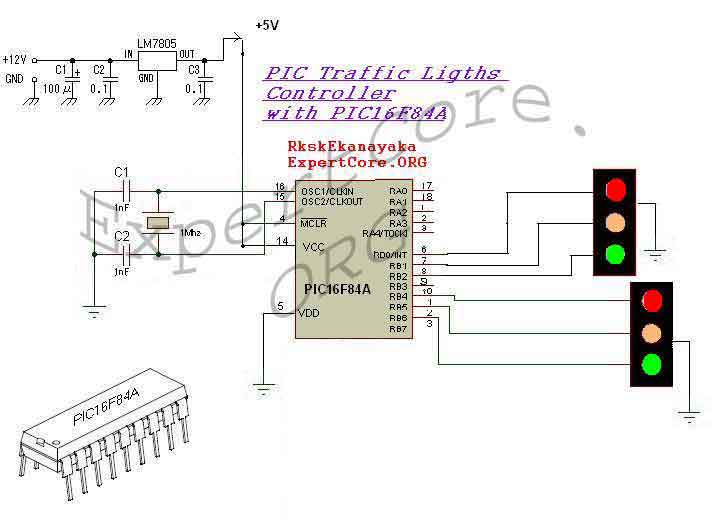

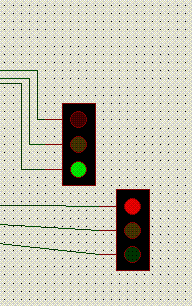

There is an example PIC Traffic Lights Controller with PIC16F84A.
I have posted C and ASM source codes also.

I think this example will give a guid for beginners.
Please add your comments.
