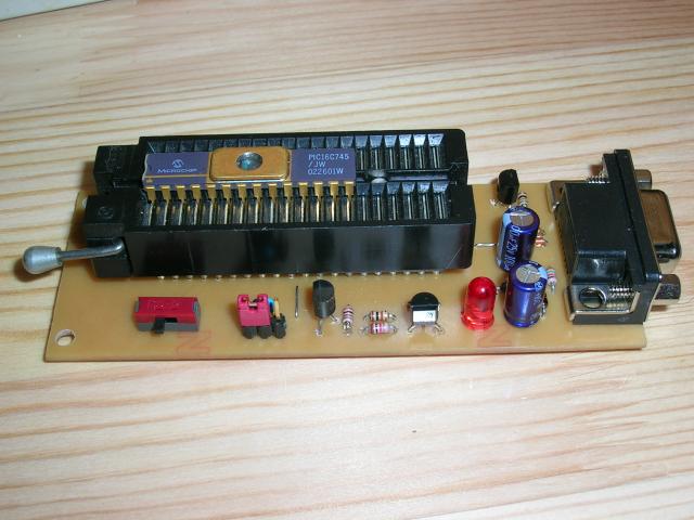

Top view
top view.jpg (43.04 KiB) Viewed 9856 times

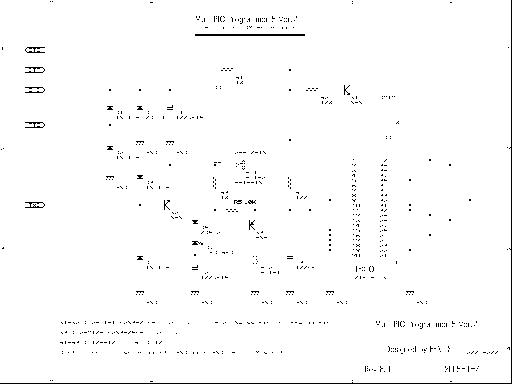

Schematic

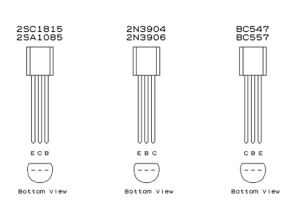

Typical pin out for TO-92 Transistors
