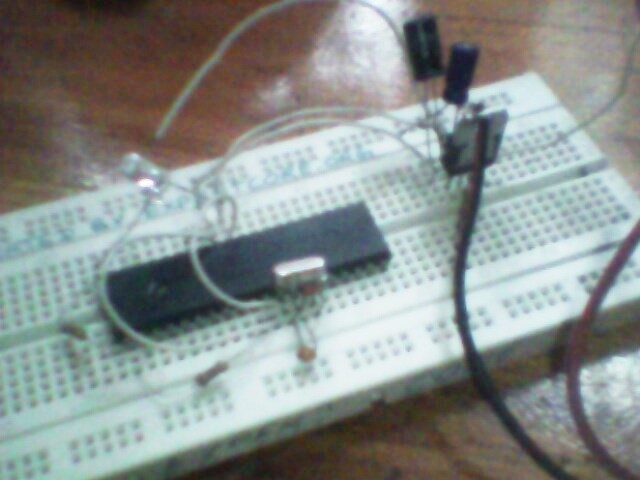

Hi,
I programmed above project to a 877 with PICPgm. It showed pic programmed successfuly and verified it.
Then I built the circuit on project board.
and powered it, but it doesn't gets any result.
{Circuit and power supply is ok}
project board.jpg (51.45 KiB) Viewed 16764 times
What Can be the bug??????????
Thankz.

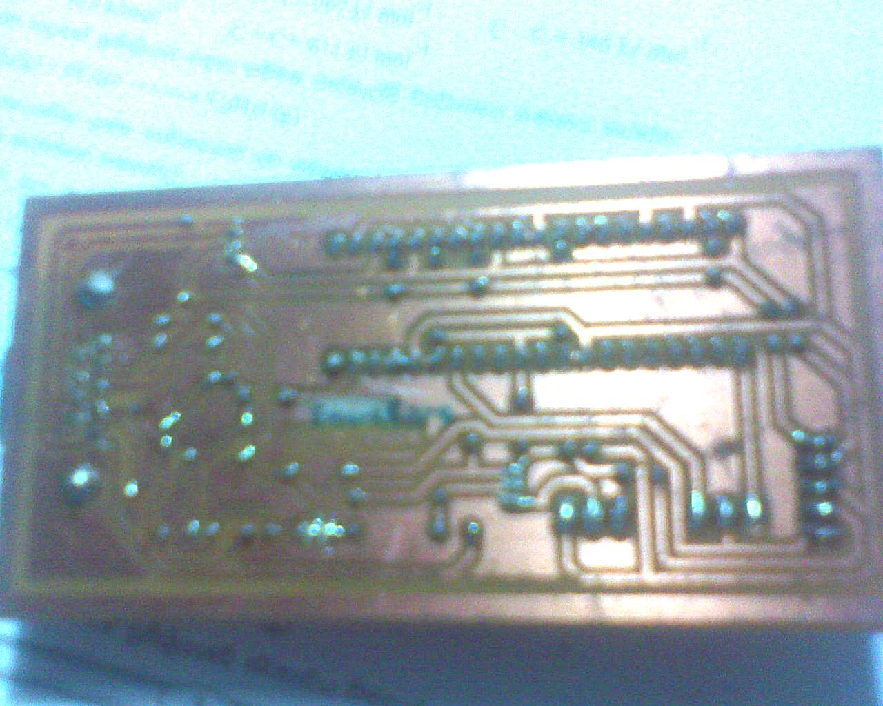

Post by Rksk » Sat May 15, 2010 2:58 am
There is the PCB side of my JDM.
{requested by neo}
Re: A trouble with JDM programmer
Post by Rksk » Sun May 16, 2010 9:24 pm
Still WinPic shows errors, but PICPgm has programmed and read from pic with this JDM. it read the programme wich ROBOT.LK team wrote to the PIC for testing. But I can't use programmed PICs with circuits, they don't work.
Post by Neo » Sun May 16, 2010 9:36 pm
What's the pin you have connected the LED?
How about writing a new program to toggle the pin as in your target circuit ?
