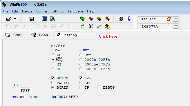

Open WinPic, click on Settings in the Toolbar and see whether you have the settings as in the following screenshot.
You might have different configuration here.

Re: A trouble with JDM programmer
Post by Rksk » Tue May 11, 2010 3:16 pm
Hi,
above settings are alredy ok.
B.R.
Thanks.
Post by Magneto » Tue May 11, 2010 9:33 pm
Hi friend ,
There is some correction has to done in above configuration diagram.
Under Osc , you have to select XT , not RC. If you select RC , it will take clock pulses from Internal oscillator.
Microcontroller taking clock pulses , from our external Crystal , only if we select XT.
Regards
Post by Neo » Wed May 12, 2010 12:55 am
I have updated the above image according to Magneto's note.
RKSK, can you confirm it is working now?
