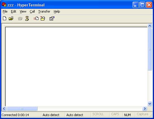

Now you have three more things to do.
1. remove the cable from the PC and directly short the Pin 2 and Pin 3 of your computer serial port. And as you did ,
write someting on the hyperterminal and see , wheter you can see what you are typing. This test has no effect of the
cable and if this fail , we can definetly say your computer COM port has some problem and then you have to go for another computer.
2. If above test is successful , check continuity of your serial cable in femal and male sides.
That mean check the continuity of femal pin 2 and male pin 2. and check the continuity of femal pin 3 and male pin 3.
if this is ok , we can think that your cable is ok.
3. Or else you can ask serial cable from your friend and try or you can buy a new one and try. They are not expensive.

Can you did the number one step of my above post and tell us the results
Re: A trouble with JDM programmer

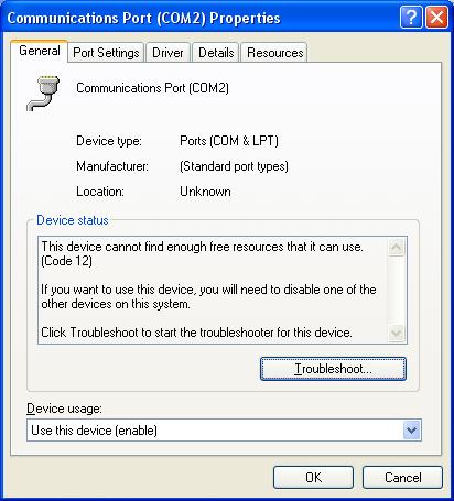

Post by Rksk » Thu Apr 29, 2010 5:53 pm
Dear Magneto,
It only shows that,
I think it says an error of my serial port (COM1).
COM2 has an error in settings.
COM2 settings.JPG (40.41 KiB) Viewed 18219 times
Can I resolve this problem and use COM2 with JDM ?
Thanks...
Post by Rksk » Thu Apr 29, 2010 11:19 pm
Friends,
Neo helped me to solve COM2's problem.
I had connected i internel modem to PC therefore COM2 have used by it and
COM2 had disabled in BIOS.
He helped me to find them and resolve by spending his worth time. :)
Thanks...
