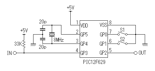

Have you considered the oscillator in PIC12F629?
PIC12F629 has a 4MHz internal oscillator. However you could connect an external oscillator if you want but since it has very few pins, external oscillator is not always used. Following is a circuit with external oscillator.
The datasheet says you can go up to 20MHz.
Here we address your issue. Have you changed the delay.h based on the frequency of your oscillator? You need to change line #define PIC_CLK 4000000 //4Mhz according to your oscillator frequency.
