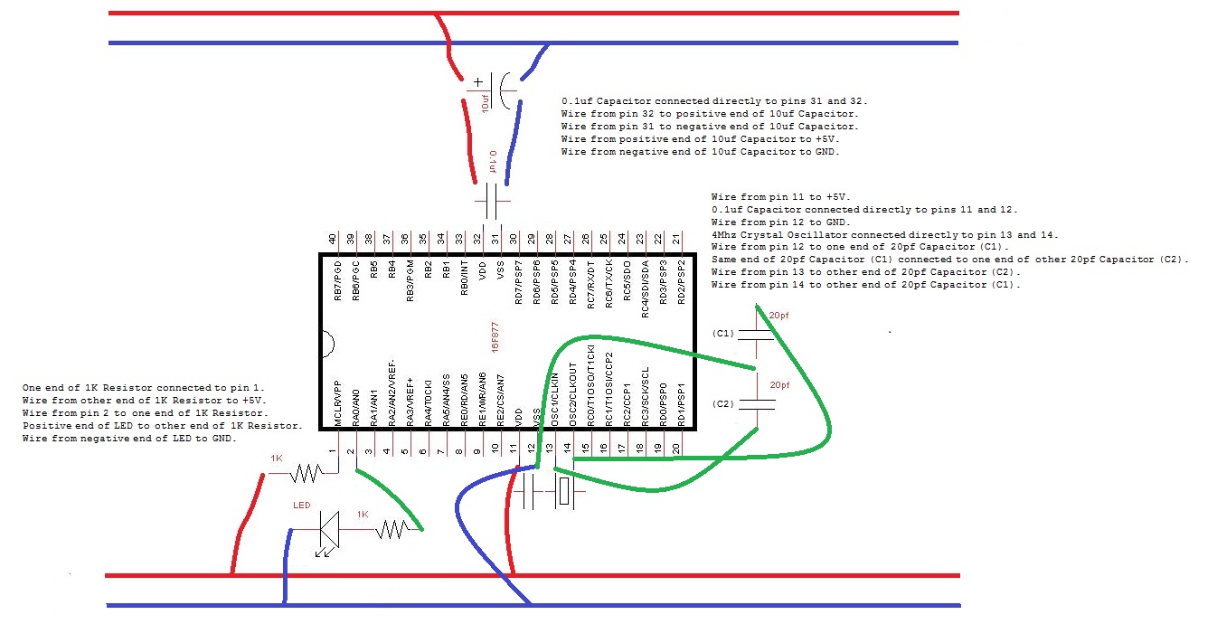

hi. i have made that change to the circuit however it is still not working. i have attached a diagram of my circuit which hopefully shows clearly what everything is connected to.
Thanks.

Re: How to start with Microcontrollers
Post by Neo » Fri Jun 17, 2011 1:14 am
Circuit is correct according to what I see. However I see a problem in the way you wired the PICKit3 to the micro.
I think you missed to provide power to 2 VDD and 2 VSS Pins. I see you have given power to pin 11 & 12 but not to pin 31 & 32.
I have added a little article on this. See How to connect PICKit3 to PIC16F877A.
Make sure that you have given external power using a 7805 regulator to the micro when you are programming. Don't expect to get it powered by the USB.
Lets see how it goes.

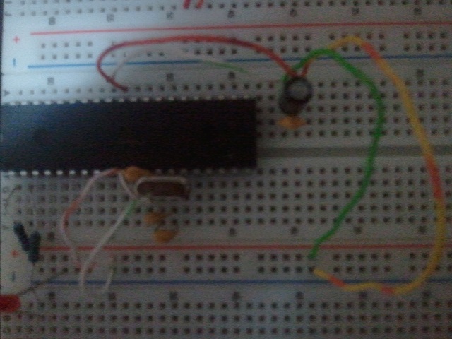

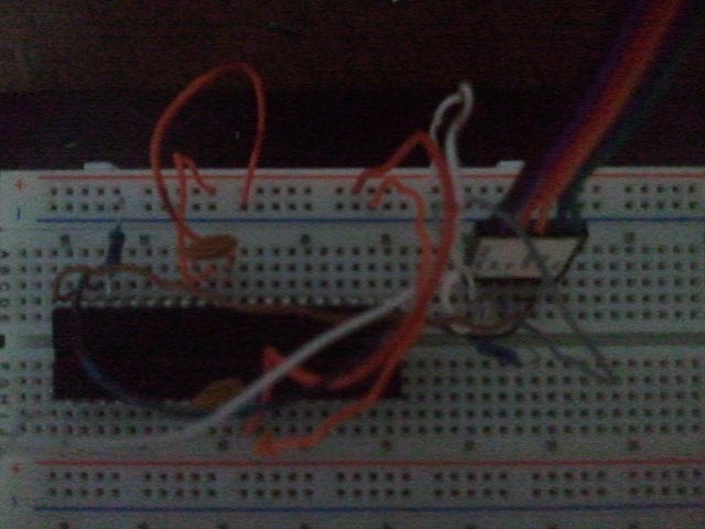

Post by DPX » Fri Jun 17, 2011 6:20 pm
Ok my camera is not very good. I will list the connections which hopefully make it easier to follow.
Programming
top view when programming.
Pin 1 (MCU) to pin 1 (ISCP).
10K Resistor from pin 1 (ISCP) to pin 2 (ISCPVdd).
0.1uf Ceramic Capacitor from pin 11 to pin 12.
Pin 11 to +5V.
Pin 12 to GND.
0.1uf Ceramic Capacitor from pin 31 to pin 32.
Pin 31 to GND.
Pin 32 to +5V.
10K resistor pin 38 to GND.
Pin 39 (MCU) to pin 5 (ISCPClk).
Pin 40 (MCU) to pin 4 (ISCPDat).
Pin 2 (ISCPVdd) to +5V.
Pin 3 (ISCPVss) to GND.
LED Circuit (Note: has been rearranged, Switched the network 1k resistor to 1K film resistor)
top view of led.
top view of led.
1K Resistor to pin 1 and +5V.
1K Resistor from pin 2 to positive end of LED, negative end of LED to GND.
0.1uf Capacitor from pin 11 to pin 12.
Pin 11 to +5V.
Pin 12 to GND.
20pf Capacitor from pin 12 to pin 13.
20pf Capacitor from pin 12 to pin 14.
4Mhz Crystal Oscillator from pin 13 to pin 14.
Pin 31 to negative end of 10uf Electrolytic Capacitor.
Pin 32 to positive end of 10uf Electrolytic Capacitor.
0.1uf Capacitor from positive end of 10uf Electrolytic Capacitor to negative end of 10uf Electrolytic Capacitor.
Positive end of 10uf Electrolytic Capacitor to +5V, negative end of 10uf Electrolytic Capacitor to GND.
Post by Neo » Fri Jun 17, 2011 7:13 pm
These two are confusing. Can you remove both and put a 10K one from pin 1 (micro) to VDD (+5V). I guess you have added two here. Since the PICKit3 user manual recommends a 4.7K to 10K one, I thought it is safer to put a 10K one instead of 1K as in our circuit diagram.
Should be pin 36 (PGM) right? This is not very important. But grounding pin 38 (RB5) has no use at all.
Rest of the pin connections are perfect for me.
Post by DPX » Fri Jun 17, 2011 7:46 pm
Please note i am programming in first circuit and then once i have programmed the chip i place it in the other circuit. So to answer your comments.
Pin 1 (MCU) to pin 1 (ISCP), 10K Resistor from pin 1 (ISCP) to pin 2 (ISCPVdd)
Used when programming. I followed your suggestion from the tutorial you added in How to connect PICKit3 to PIC16F877A.
Neo wrote:Note 1: It is good to add a 10K resistor between pin 1 (MLCR') and VDD as in the first image.
Used in LED circuit and follows your original circuit diagram.
10K Resistor pin 38 to GND
Neo wrote:Should be pin 36 (PGM) right? This is not very important. But grounding pin 38 (RB5) has no use at all.
Used in programming. Again i followed your note in How to connect PICKit3 to PIC16F877A. Sorry i only looked at pin number and not description.
Neo wrote:Note 3: It is also good to put a 10K resistor between pin 38 (PGM) and ground (this could avoid programming-troubles.
