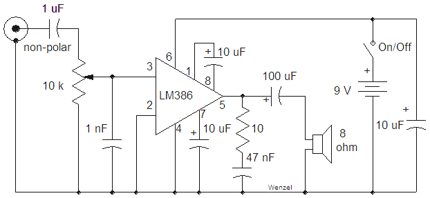

it seems you have to amplify the out put of PIC.
Below cricuit is very easy to build. tryout it.
LM386 Amp circuit
LM386 Amp circuit

Thanks , sure, tomorrow i will try to build that amplifier circuit. and also try to get the same piezo speaker.

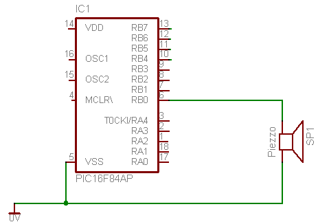

Do a little modification to the main circuit given by Rksk as below. (Only RB0 is connected to the Piezzo speaker and the other end of the speaker is connected to 0V). Keep RB1, RB2 and RB3 unconnected. Don't worry, 1 pin would be enough to power a Piezzo speaker.
I'm adding the C code for playSound function.

Note that, since 's' is the index of frequency table, you can pass 0 to 6 for different frequencies.
The above C code will work on HiTECH C compiler. However with little modifications to port writing codes, you can get this working for any platform.
deepak, What's the C++ compiler you use for PIC?
By grounding one side of the speaker and a little change to code that operates on RB0, RB1, RB2 and RB3, I think you would be able to get your code working.
