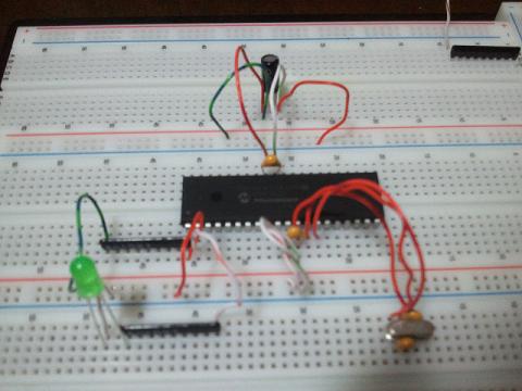

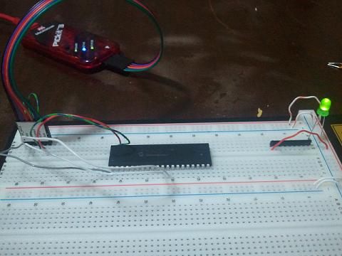

So just give details. I am building and programming the chip through MPLab IDE. I am using the pickit 3, the programmer and chip both appear to be detected correctly. I have attached screenshots and images of my circuit configuration. Hopefully you can make out what is happening from the images.
Thanks.

I had a look at the images. According to what I see the wiring is correct. However there is a small mistake you made.

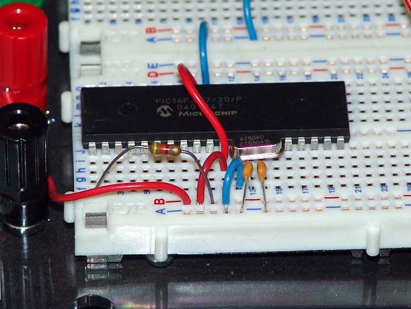

You need to fix the Oscillator with 2 caps as much as close to the micro as in the following image. Having wires to connect the Osc to micro will probably give you unexpected problems.
Let me know how it goes.
Note: Please put smaller images next time (just as the one I posted). You can open it with Paint and go to Image -> Stretch/Skew and reduce the size by putting 50 to both Horizontal and Vertical boxes under Stretch until the image is reduced to a smaller size as the one I have posted. I changed your attachments as an example.
