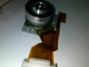

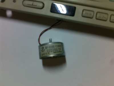

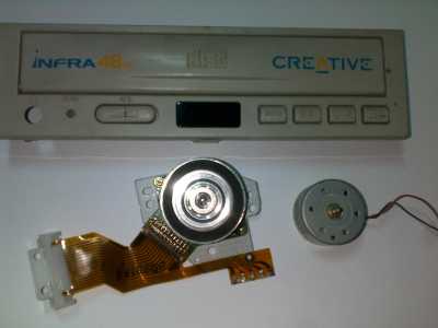

Hi,
For ejecting a CDROM small motor which has only 2 wire connection red and Black. and main Motor having 11 connection
which are those?? and which type of these motors ?

First one looks like a Brushless DC (BLDC) motor. Most pins on the connector must be the ones connected to hall-effect sensors. I guess there are few.
Second one looks like it has only 2 wires right? Then it should be just a DC motor which is simple to operate. If you need more control over a DC motor as such, you can do that with H-Bridge circuit. H-Bridges are available as ICs that are simple to control using a micro.
On the first one, you will have to do some experiments with a multimeter to identify the wires that are going to the motor. Once you make the motor working, you can move to hall-effect sensors as you wish. I guess we can expect some help from NTSH on this.
