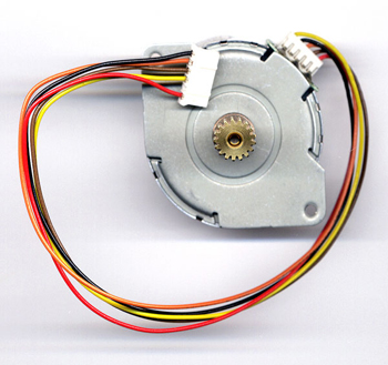

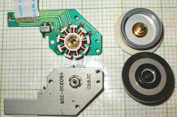

You will have to first disassemble it and get the motor(s) out carefully.
According to my knowledge, a CDROM has both stepper and servo motor. Stepper is used for the tray in/out and the servo (BLDC servo) is used to spin the disk.

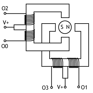

A Unipolar Stepper motor has 5 or 6 wires. A brushless DC (BLDC) motor (servo type) has a minimum of 3 wires (Power supply and PWM speed control). Additional wires are for sensors such as hall effect sensors which are built-in to the motor.
A Unipolar stepper motor.
Wiring diagram of a unipolar stepper motor.
Brushless DC motor (Notice the sensors)
To drive a unipolar stepper motor, you can use a driver IC like L293D. If you are going to use the Servo one, then you can directly drive with a PWM pin on the micro. For both cases, you will have to carefully distinguish the wires.
If you can take clear photographs of the motors, then we might be able to tell you what is it. NTSH has already experimented with this so he will help you as well.
