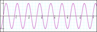

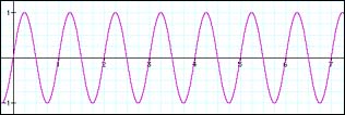

Graph 3.1: Let this be the waveform of a measured signal with a frequency that is exactly that of a bin
Graph 3.2: Let this be the waveform of a measured signal with a frequency that is not on a bin frequency
These two graphs look pretty normal, except that we see that the two signals obviously do not have the same frequency - the one depicted in 3.2 is of higher frequency than our sine wave in 3.1. We have announced that we will use short frames for analyzing our signals, so after splitting it up into our analysis frames it will look like this:

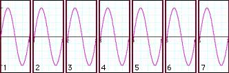

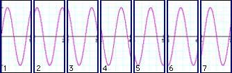

Graph 3.3: Our signal of 3.1 now split into 7 frames. Each frame will be passed to our transform and be analyzed
Graph 3.4: Our signal of 3.2 now split into 7 frames. Each frame will be passed to our transform and be analyzed. We see that while the signal in 3.3 nicely fits into the frames, the second signal appears to have a phase shift in each window
Our sampled signal from 3.1 that is exactly centered on a bin frequency nicely splits up into seven successive analysis frames. In each frame, the waveform starts out at zero and ends with zero. To put it more exactly: in each frame, the measured signal starts at the same point in its cycle, that is, it starts with the same phase.
Our sampled signal from 3.2 that is somewhere between two bins in frequency does not nicely split into our seven successive analysis frames. In each frame, the waveform has a clearly visible phase offset, i.e.: it begins at a different point in its cycle. The more off-center it is in frequency from the bin frequency, the larger this phase offset will be. So, what we see here is that while signals whose frequency is exactly on a bin frequency have the same phase offset in each frame, the phase of signals that have a frequency between two bin frequencies will have an offset that is different with each frame. So, we can deduce that a difference in phase offset between two frames denotes a deviation in frequency from our bin frequencies.

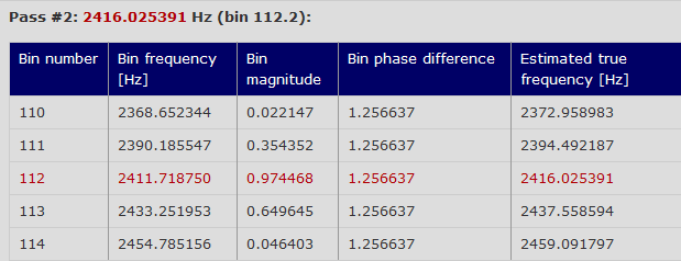

To see why this is the case, let us first consider how we actually measure the bin phase. As we can see from our source code example, we use the arc tangent of the quotient of sine and cosine part (in the source code example, they are referred to as imaginary (im) and real (re) part of each bin for mathematical terminology reasons). The sign of the sine and cosine parts denote the quadrant in which the phase angle is measured. Using this knowledge we can assume that the bin phase will always be between -? and +? at any time, since this is the range of our atan2() functions’ return value. Therefore, the increase in phase between any two adjacent frames has an upper limit, with a negative angle difference denoting a negative deviation from the bin frequency and a positive angle difference denoting a positive deviation in frequency from the bin frequency. To make sure the phase difference value is centered around 0 (ie. measured as an absolute value against the origin, that is, always in the range ±? which we need in order to measure the frequency deviation) we wrap the phase difference back into our ±? interval. This is necessary since the phase offset we subtract out to make up for the overlap may cause our phase difference to be outside that interval.

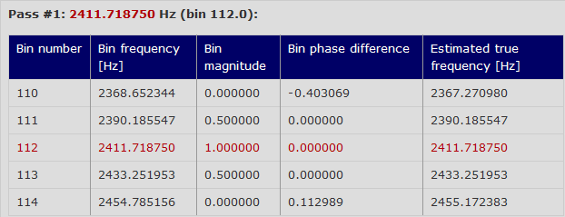

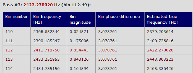

Now, in the simple case that any two adjacent frames will not overlap and we know we have an interval of ±? to denote the deviation in frequency of one partial from our bin frequency, we would only be able to discriminate a frequency deviation that is ±0.5 bins since this is the maximum advance in phase between two frames we can unambiguously discriminate in this case. When the frequency of our measured signal crosses the boundary between the two adjacent STFT bins, the phase difference will wrap back to the beginning of our interval and that partials’ frequency will be far away from the actual frequency of our input sinusoid.
We can see that when we start out at exactly the frequency of bin 112 as shown in the table of pass #1, the true frequencies for all channels that are significant (i.e.: have nonzero magnitude) are correctly centered on their bin frequencies as is to be expected considering we use a frequency that is a perfect fit. The 0.5 value for the magnitude of bin 111 and 113 is due to the windowing we use. When we increase the frequency of our measured signal in pass #2 to be 20% away from the 112th bin’s frequency, we see that bin 112 correctly tracks our signal, while the bin above, towards which the frequency moves, goes even farther away from the correct frequency although its magnitude increases. This is because it wraps back in its interval and actually goes into the opposite direction! This gets even more evident in pass #3 which shows that the 113th bin (which should actually be closer to the true frequency of our measured signal now according to its magnitude) goes even more into the wrong direction.

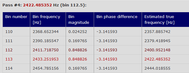

In pass #4, the frequency of our measured signal is now halfway between two bins, namely between bin 112 and 113. We can see this from the bin magnitude, which reflects this fact by having an identical value for these two bins. Now bin 113 takes on the correct frequency, while bin 112 wraps back to the beginning of its interval (from 3.079 =~ 3.1415 [+?] to -3.1415 [-?]).

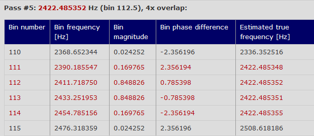

For comparison, here’s how the numbers look like when we use an overlap of 75%:
When we want to alter our signal (which we need to do in order to achieve the pitch shifting effect), we see that with no overlap we easily run into the scenario (depicted in pass #4 above) where on resynthesis we have two sinusoids of equal amplitude but actually one bin apart in frequency. In our case, this would amount to a difference in frequency of about 21.5 Hz. Thus, when putting our signal back together we would have two sinusoids that are apparently 21.5 Hz apart where we had one single sinusoid as input. It is not surprising that the synthesized signal will not sound very much like the original in this case. Clearly, when we just resynthesize the signal without pitch shifting we can expect that these effects will cancel out. However, this no longer holds in the case when we alter our signal by scaling the partial frequencies - we would expect that this will introduce an audible error in our signal since the wrapping will now happen at a different rate.
When we look at pass #5 which uses a 4x overlap (ie. 75%), we see that all adjacent sinusoids down to a bin magnitude of 0.17 (approx. -15 dB) have about the same frequency, the error can be considered negligible. The next sinusoid that does not have the correct frequency is approximately -32dB down, which is much better than in the case where we used no overlap. Thus, we would expect this to sound considerably better. As you can easily verify with the code below, this is indeed the case.
Summarizing the above, we see that choosing a larger overlap, which is actually oversampling our STFT in time, increases our ability to estimate the true frequency of our measured sinusoid signal by making the range in which each sinusoid can deviate from its bin frequency larger: a range of ±1/2 period (±?) has a different meaning when we space our frames more closely, as the same phase difference for 2x and 4x overlap means twice as high a frequency deviation in the 4x case than in the 2x case. Thus, the closer we space our frames, ie. the more they overlap, the better we will be able to determine our true sinusoid frequencies in our measured signal. Of course, the computational cost will also increase, since we need to perform twice as many STFTs when we increase our overlap from 50% to 75%.
As a consequence for its practical implementation we now see why we need an overlap that is sufficiently large: if we have a measured signal whose frequency is between two bins, we will have two bins with large magnitude. However, since the true frequency is somewhere between the two bins and each bin can only deviate by a fixed amount depending on the overlap, we may have two prominent sinusoids that play at two different, yet close frequencies. Even worse, if the true frequency of the sinusoid is between the two bins k and k+1 like in our example shown in pass #4, the frequency of the sinusoid k will move farther away from the true frequency since its phase difference will - trying to lock on the frequency of the input sinusoid - wrap into the opposite branch. This will produce audible beating in our re-synthesized sound and thus scramble our result. A 75% overlap remedies this situation: adjacent sinusoids down to an acceptable magnitude are now able to always lock on the true frequency without wrapping - they have become more “flexible” in frequency which will yield a considerably better sonic quality. As a result, the beating is almost completely gone.
