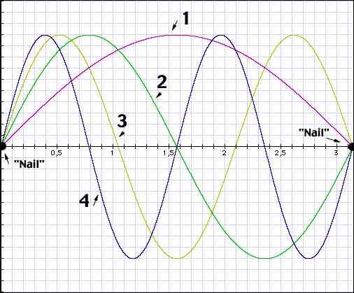

All well and good, but still we don’t know how many of these sine waves we finally need. As we now know the lower and upper frequency any partial sine wave can have, we can calculate how many of them fit in between these two limits. Since we have nailed our lowest partial sine wave down to the leftmost and rightmost samples, we require that all other sine waves use these nails as well (why should we treat them differently? All sine waves are created equal!). Just imagine the sine waves were strings on a guitar attached to two fixed points. They can only swing between the two nails (unless they break), just like our sine waves below. This leads to the relationship that our lowest partial (1) fits in with 1/2 period, the second partial (2) fits in with 1 period, the third partial (3) fits in with 1 1/2 period asf. into the 1000 samples we are looking at.
Graphically, this looks like this.
The first 4 partial sine waves:
Now if we count how many sine waves fit in our 1000 samples that way, we will find that we need exactly 1000 sine waves added together to represent the 1000 samples. In fact, we will always find that we need as many sine waves as we had samples.
