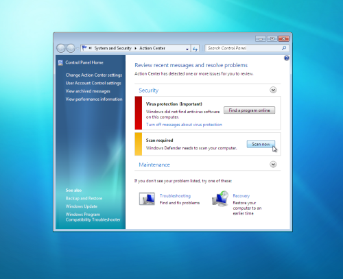

  3. Action Center
    Windows 7 replaces the Security Center with the more all-purpose Action Center, which warns you of PC maintenance and back-up issues as well as potential security problems. It’s prone to complaining if your security settings don’t meet its approval, but at least now there’s an effective solution.
    If you regularly see messages telling you that you’ve turned the Windows firewall off, say, then you can choose to disable just those while leaving the more useful alerts active.

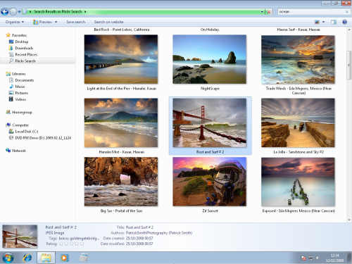

  15. Search connectors
    Windows 7 adds support for search connectors. These are small configuration files that extend the Windows Search tool to include online resources. To add Flickr support, for example, visit http://www.istartedsomething.com/flickr search to download and open the connector. This will add a Flickr Search option to your Searches folder, and you’ll be able to search the site from within Explorer.

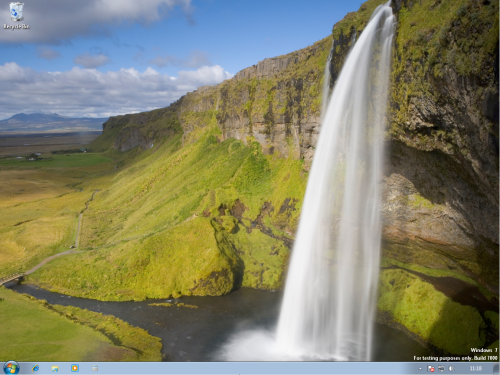

  26. Cycle different wallpapers
    Windows 7 includes so many new wallpapers that it’s difficult to decide which one you like the best. But who cares? You’re now able to select multiple images and have Windows cycle through them, creating an ever-changing desktop.
    It’s even possible to have a Windows theme that pulls its background from an RSS feed. This can be used to display the latest news on your desktop. This feature isn’t fully implemented in the beta, though, and we're not sure if it’ll make it to the final release.
