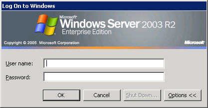

By default on Windows Server 2003 logon dialog box, the shutdown button is disable for security reasons.
This is how to enable it.
Win2003 Logon
Win2003 Logon
To enable the shutdown button on a standalone Windows Server 2003 based computer, follow these steps:
