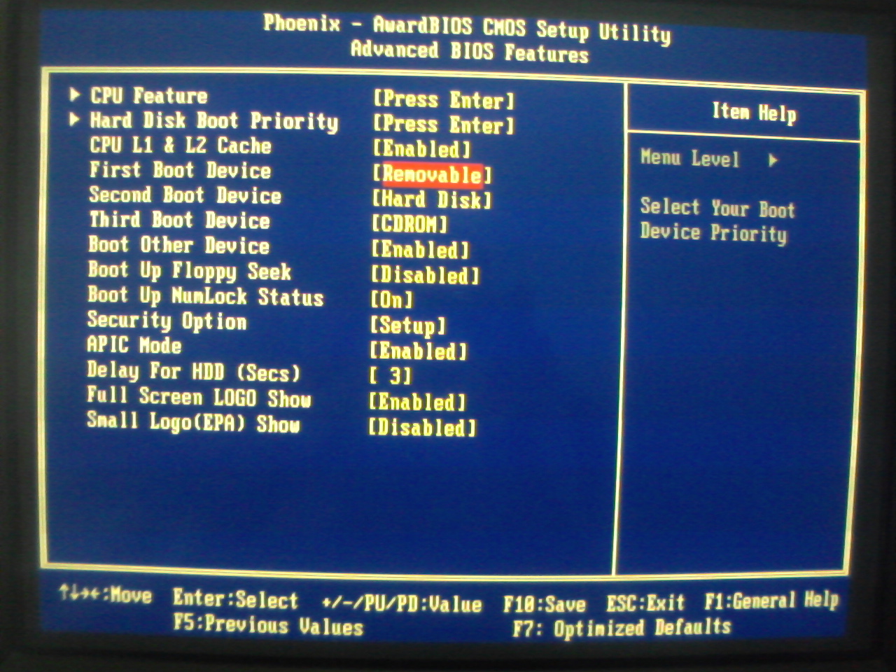

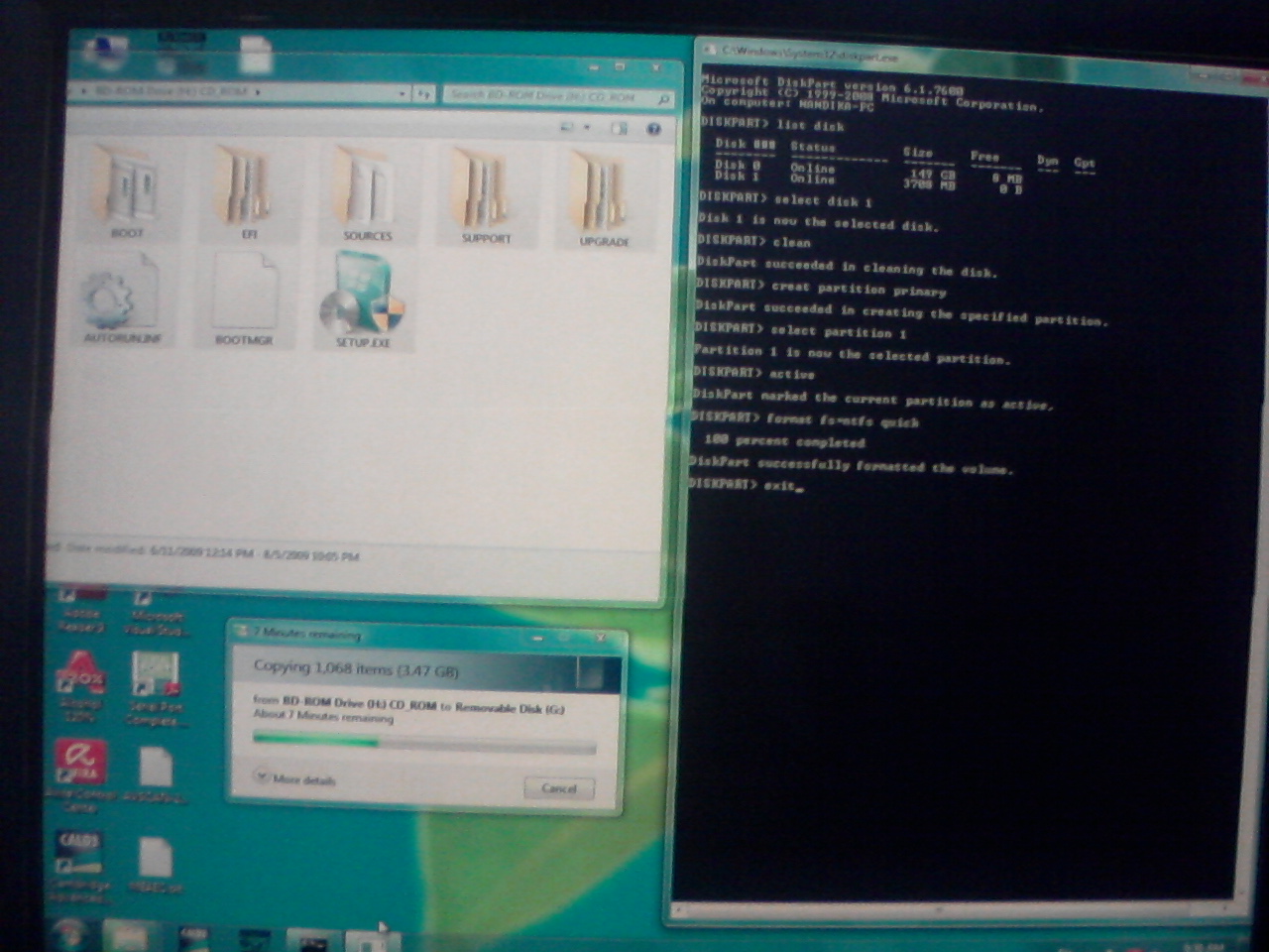

Post by Nandika » Thu Jan 26, 2012 11:21 am
flowing are some images while did my methord.
i cant connect my computer using cable or bluetooth.
there are photo taken by me from my mobile.
and i cant post all in one post.i tried,lost my time only.

Post by Nandika » Thu Jan 26, 2012 11:38 am

Location: Galle-Sri Lanka
Re: Install windows 7 From Pen drive
Post by Nandika » Thu Jan 26, 2012 11:59 am
