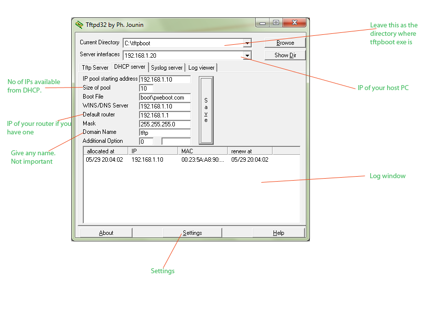

First download and extract the tftpboot from the given links. Then start configuring the tftpboot. I will give a quick guide.
Here my tftpboot.exe is at C:\tftpboot\tftpboot.exe. So I am using C:\tftpboot as the current directory. (Not the obvious reason, but this is to make simple and easy)
Here I have assigned a static IP address to the computer that I am running tftpboot. It makes things a little bit easier later on.
IP pool starting address is the IP which this DHCP server starts allocating address with. I have left pool size as 10. This will allow 10 computers to be connected to the tftpserver simultaneously.
Boot file is the file that will be initially loaded and then it will load Windows Pre-Installation Environment
http://en.wikipedia.org/wiki/Windows_Pr ... nvironment
The DNS server is not very important. But the default gateway should be the IP of the router you are connected to. Otherwise you might experience problems later.
Put something in Domain Name box and hit save. You will have to restart tftpboot in order to the changes to take effect.

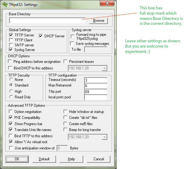

Then click settings button at the bottom of the tftpboot main window
Check your settings with this one.
