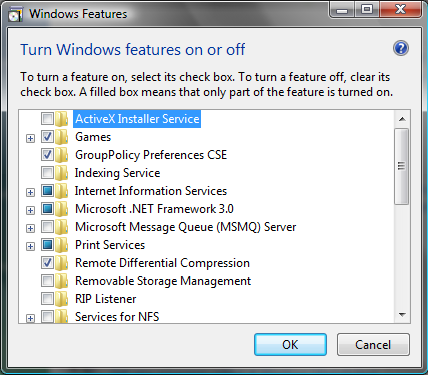

To disable Remote Differential Compression,
  1. Click Start – Control Panel – Programs – Turn Windows features on or off
  2. Untick Remote Differential Compression and click OK.
  3. Restart the computer and you should see an improved performance with copying files.
