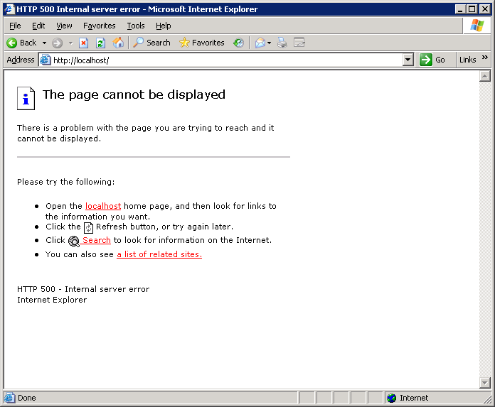

The installation of PHP on IIS is pretty straightforward so I was a little surprised when I was presented with the following error after browsing to http://localhost to check that everything was working.

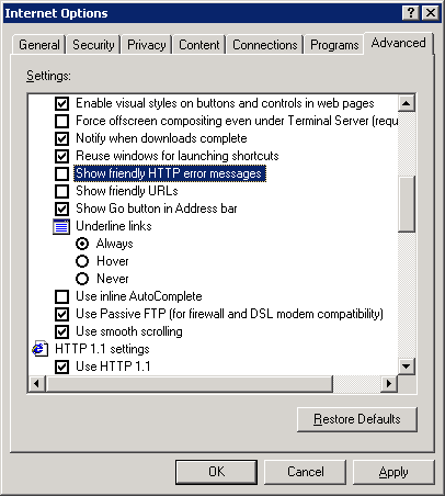

The first thing I always do when troubleshooting a problem is to make Internet Explorer give me a useful error message to work with. You can do this by clicking Tools | Internet Options | Advanced and then unticking ‘Show friendly HTTP error messages’ as shown here

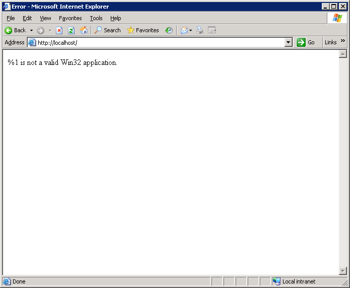

Once this was done I was able to see the actual error message being returned to the browser as shown here :
Since my previous experience with 64-bit Windows and IIS was pretty limited I hadn’t encountered this particular error message before but a quick scan through the various newsgroups and Google quickly revealed the cause of the problem.
Without realising it I was trying to load a 32-bit application (in this case PHP) inside a 64-bit worker process and it was this that was causing the 500 Internal Server error I was seeing in my browser. Since the latest Windows distribution of PHP from http://www.php.net is only available in 32-bit version you need to configure IIS to run in 32-bit mode if you are using a 64-bit version of Windows.

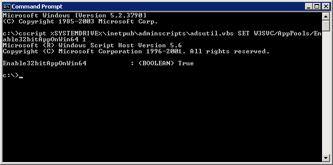

In order to configure IIS to run in 32-bit mode you need to execute the following command :
cscript %SYSTEMDRIVE%\inetpub\adminscripts\adsutil.vbs SET W3SVC/AppPools/Enable32bitAppOnWin64 1
This will set the Enable32bitAppOnWin64 metabase property to True as shown here :
It is important to note that IIS 6.0 does not support running in both 32-bit and 64-bit modes at the same time - in other words this is an ‘all or nothing’ system wide setting which affects all IIS web sites on the server, so if you need to run both 32-bit and 64-bit applications in IIS you will either have to locate them on separate machines or run them all in 32-bit mode.

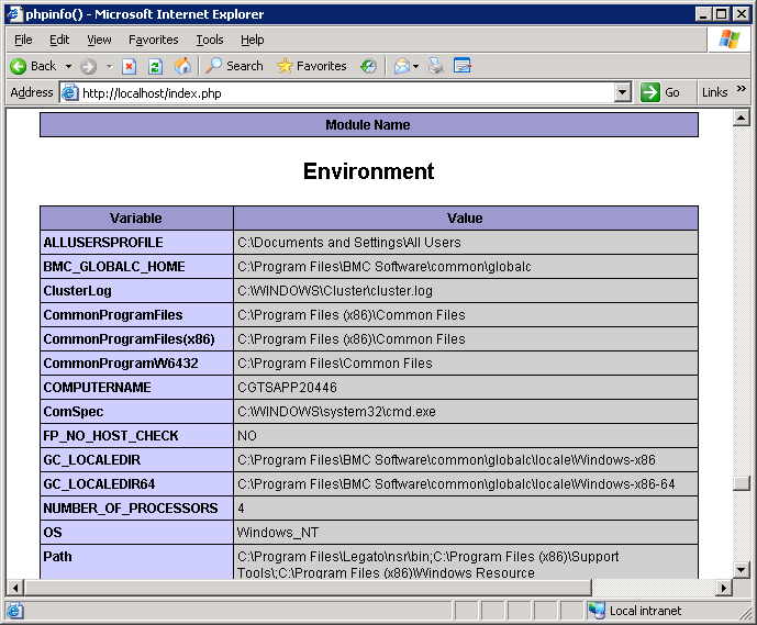

Now, when I browse to http://local/index.php the page loads correctly and I can run PHP applications on my 64-bit IIS server.
