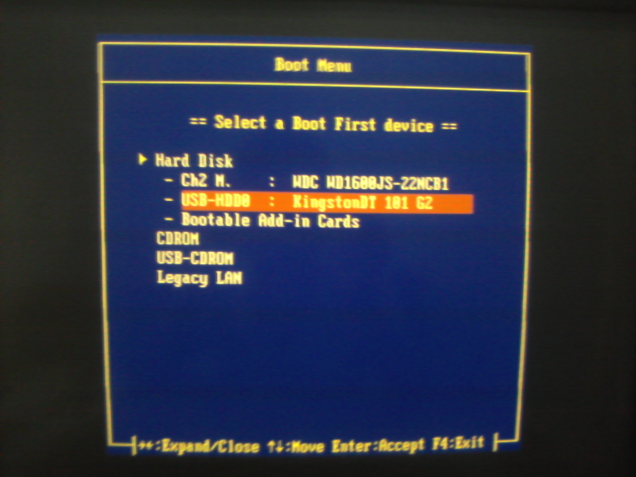

Quick boot menu

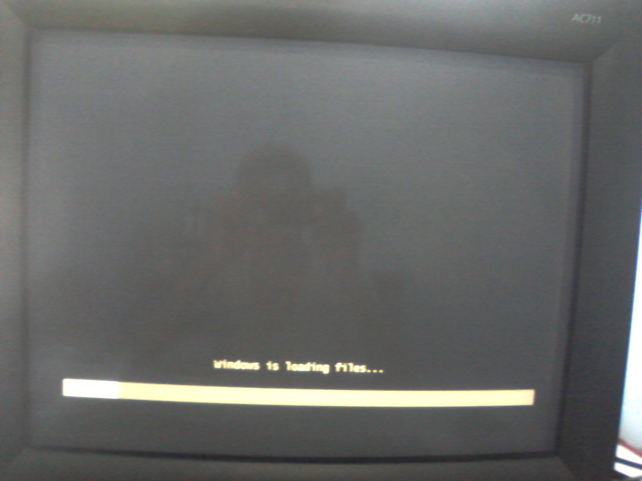

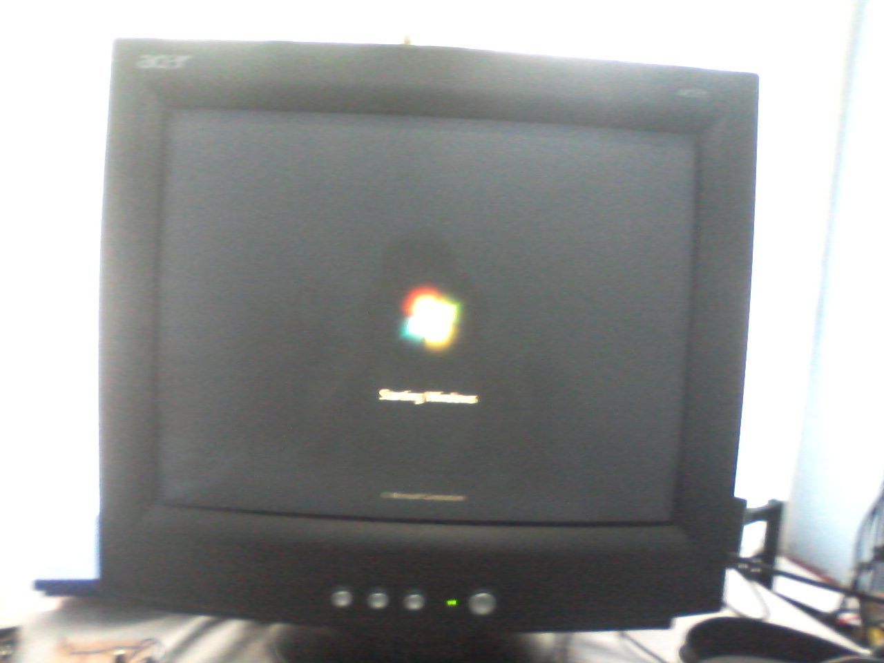

he...
now booting by pen drive.
no problem.:)
