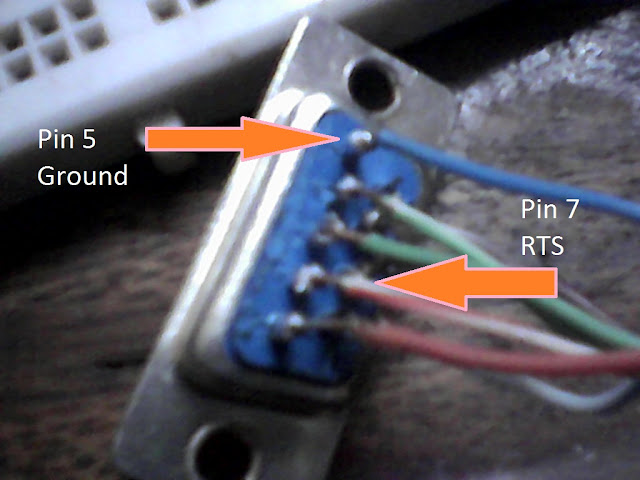

Here we need a very simple circuit.
And here is how you should connect pins to.
And here is the source code,

Note that , if you are not belongs to the administrator group then program may require you to run that
program as administrator.
x64 win7 compiled binary file and source file have been attached.
