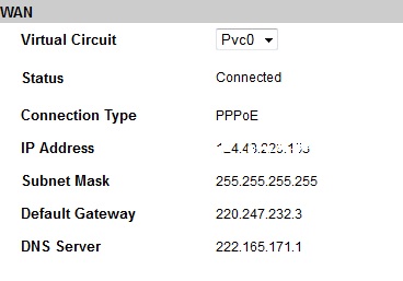

According to the network theory I leaned many years ago, I can't remember I learned any connection between network class and subnet mask. It could be calculated for each class to be useful, that is true.
When your subnet mask is 255.255.255.255, that means it is a single host subnet.
check my setting on a SLT ADSL connection with a class C WAN IP.
