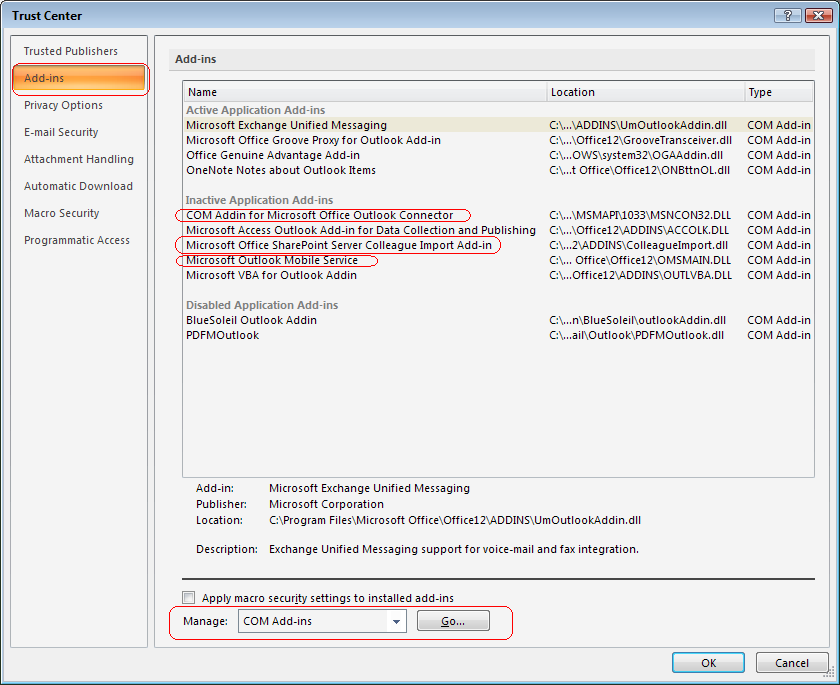

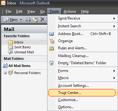

  1. Go to Trust Centre as below.
  2. Go to Add-ins

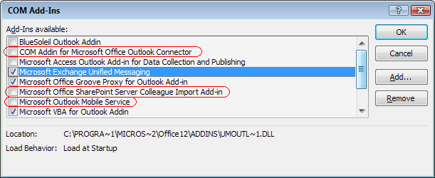

  3. Go to Manage, select COM Add-ins and click on Go (As circled in above picture).
  4. Remove ticks from above mentioned add-ins as in following image and click on OK.
  5. Restart Outlook 2007.
