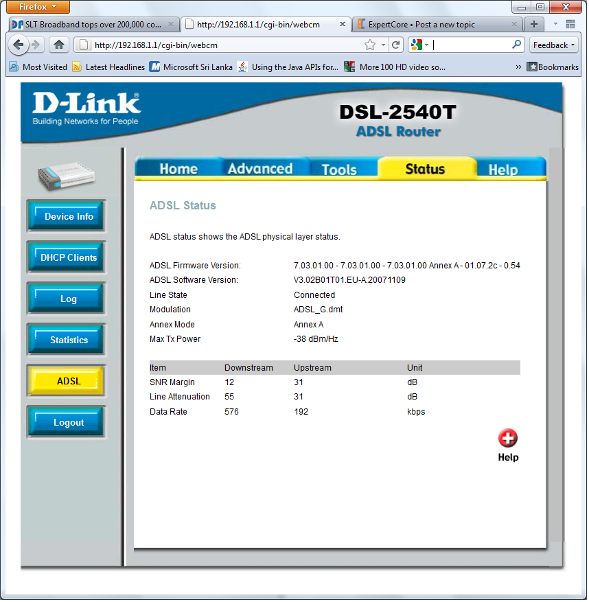

Besides the speed problem of ADSL, there is a new one. The router is connecting at strange speed. I tried changing the ADSL modulation to ADSL 2+, but it does not help. Currently I am using ADSL g.dmt. Please have a look at the screenshot. I tried googling, but could not find a cause. Although my line attenuation is high, I have been running on this like for about two years now.
http://www.tops.lk/article29702-slt-bro ... tions.html
I tried changing to ADSL 2+ since the about article stated that SLT is using ADSL 2+. But then router started showing an attenuation of 65dB. :shock:
Could this be a problem at the telephone exchange? or could it be my router?. (I rarely unplug it, it is always plugged in unless otherwise there are thunder storms)

I did not buy this router from SLT. I bought it from a computer store at unity plaza. It is a D-Link DSL-2540T .
When I put the modem to ADSL2+ Multimode, router selects ADSL2+ Annex M. And When I put it in "Not Trained", it still automatically selects ADSL2+ Annex M. Currently I am running on G.dmt.
Don't know what to do. I will try resetting the router. Router is still connected at 576kbps/192kbps. I kept the router turned off last night, but situation is unaffected. I have a sense that this could be due to some modulation mismatch. But who knows. SLT Customer service is not the best place to call for technical assistance.

I reset the router. No use :(
Tried using different modulations. It only connects at G.Dmt (ITU992.1) and ADSL2+ Annex M . When someother modulation is used, ADSL get disconnected.
Seems like something is really wrong. It is hard for me to find a another router to check my line and I will just wait and see.
It is not the router in your end. I referred the router in at the SLT end. That's the one which normally gets overloaded which the resetting fixed my issue. I'm 90% sure that they don't use good brands like Cisco, D-Link, 3Com, etc... What the tenders do for them is maximum commission, cheapest quality ;) . If they have used better ones, we would never have to complain them as such.
So just call them and report the problem. Whenever a technician calls you, ask him to reset the router which your cable is connected. Tell them you heard this work from someone who got himself fixed with a similar issue.
Another suggestion. Can you bypass the splitter and see whether all work? If this is the case, it can be lightning that blown your splitter.
If you use lighting arresters, check them too. If you don't use them for now, you better buy one from 1st cross street for a cheaper price. See these circuit diagrams if you like to build one by your own, https://robot.lk/viewtopic.php?f=73&t=2174.

Post by Herath » Sun Dec 26, 2010 6:11 pm
I connected the router directly to the wall socket.Attenuation reduced by 1dB. But speed profile is still 576kbps/192kbps. It's an increase at least in numbers. So I will see a bit more before calling SLT.
Resetting my ADSL port will be hard. My local exchange does not have an engineer as I know. So it is hard to get something done. I had to call more than 5 times to get my telephone line connected to the DSLAM. Anyway I will try calling...

ADSL is fast now. About 2x, 3x faster than day time. Should be due to low congestion. And this new speed profile for me... is this real. :mrgreen:
50kbps more download/20kbps more upload

Post by Herath » Mon Dec 27, 2010 10:03 am
Yes earlier i only got 0.44Mbps/0.10Mbps max . So it is a considerable amount of increase in upload bandwidth. Router still reports my upload as 192kbps. and download is 576kbps. :mrgreen:
