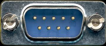

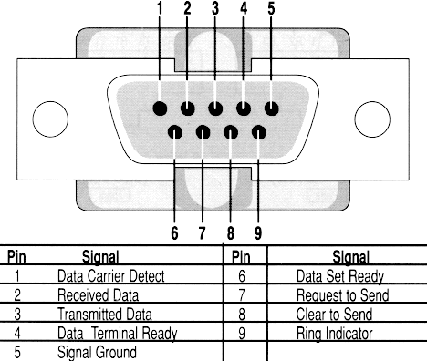

You didn't clarify what data cable you are going to use. I assume that you are going to use a the serial ports (RS232) of both machines. If that is the case, you need to use a DB9 Null- modem (or cross over cable).
You need to prepare the cable as below.
Once you prepare cable, you can use Hyper Terminal (that comes with Windows) to transfer files over serial port.
